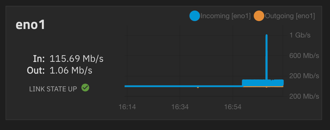

I am slowly getting up to speed with TrueNAS, I’ve built two small servers which I plan to use as Main and Backup.
I’ve finally got Rsync to work FROM OpenMediaVault TO TrueNAS.
The transfer speed is excruciatly slow - it looks like it’s capped to 100Mbit/s but I tried transferring a file manually to both OMV and TrueNas and - as you can see from the spike - it goes to full Gigabit speed. I tried on OMV and I can transfer to Gigabit speed too so network is not an issue.
Now, I understand RSync is not just transferring but these are large video files, gigabytes each most of the time.
OMV is on a very low power system but I see the CPU not too loaded. TrueNAS system is not breaking a sweat.
This pace it will take me forever, is this supposed to happen with such large files?
Thanks
I found the solution myself: de-selecting “compress” removed the “cap”.
I’d imagine OMV was not powerful enough in compressing - or maybe the extra data processing was crippling the speed.
It’s back to 1Gbit/s now.
