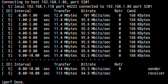

but when i tried to transfer my film library with SMB my max speed upload was
100 Mb/s i thought at the start that the problem might be bcuz i am using my on board NIC but after i switched to pcie NIC that i know support 1Gb/s transfer speed it didn’t help
i coming here to ask for help to find what capping my transfer speed

iperf3 test:

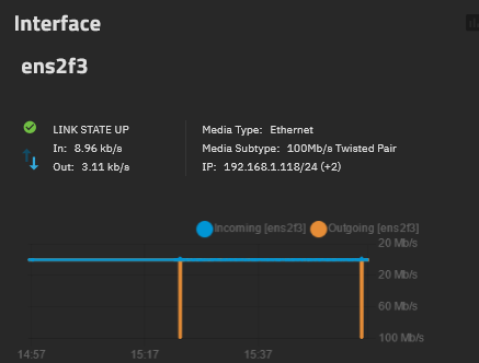

dashboard network interface:

Your GUI shows Media Subtype: 100Mbps. You have a bad cable or connection. Check the RJ45 jacks for bent pins, try another port on the router. You can also try a different port on the NIC, if you have more than one.

thank you for the reply :pray:
i connect my server directly to the switch and it went up to 1000Mbps
so its most likely the result of me being bad with my hands at crimping the cable that goes through my wall
