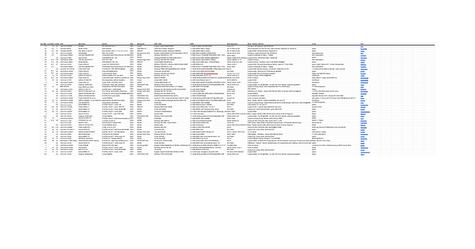

This is a very helpful list from a German forum reporting on actual (idle) usage for the listed specs.
