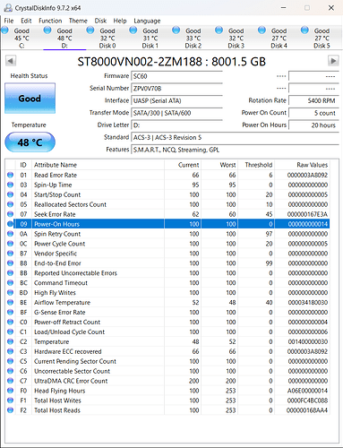

Check the SMART data of the HDD - that is very slow. Although 40MBps sounds strangely close to USB 2.0’s 400Mbps - have you attached it to the wrong port?
Its connected to a blue USB port.
Nothing looking weird to me although I’m not quite sure how to correctly interpret the seek error rate.

The part number points to an Ironwolf. CMR (I suspected a SMR drive suffereing under sustained load, nope). So it seems that the USB bridge is just terrible.
Its a bit odd! But Seagate never specified the write rate. Read rate checks out for a mechanical on USB3
So I guess this is sort of solved.
