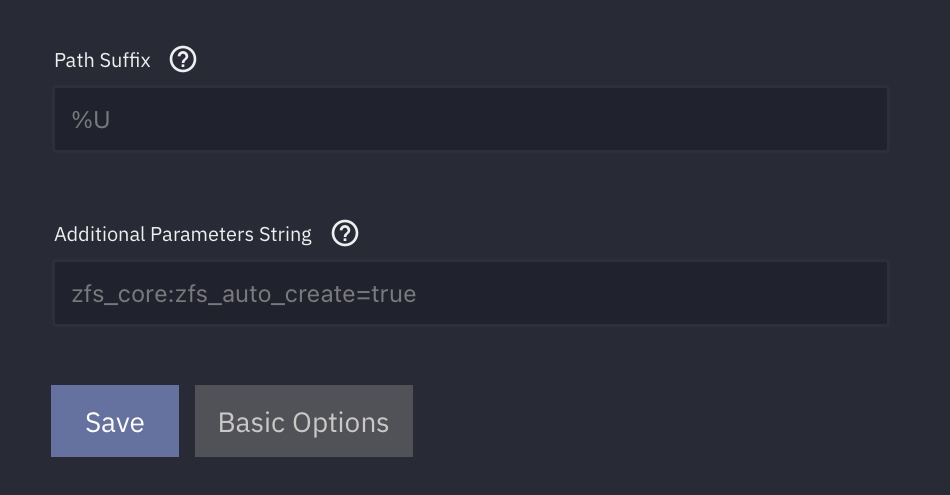

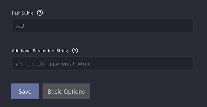

I’ve gone to advanced settings, and the additional parameters is greyed out so you can’t add anything. Am I missing something obvious?
Is this on a share? What version of TrueNAS are you on?
When I pulled up a share to look at it, the entire field was blank, and I could type in it.
25.4.0. Yes it’s a share.
