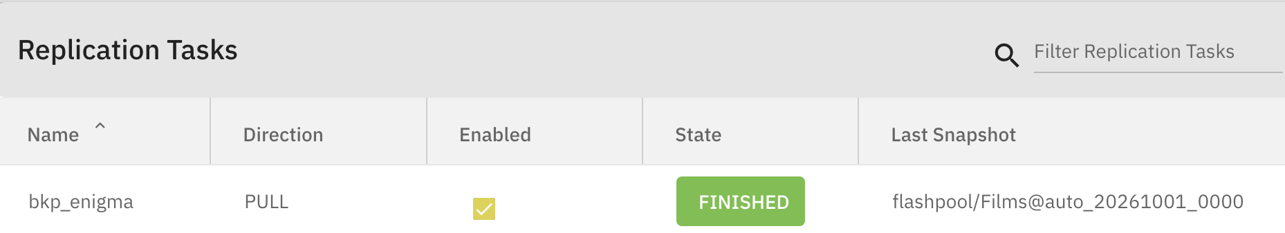

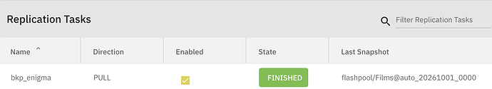

Single daily replication task on backup (for this dataset):
Result:
the monthly of September 1st and weeklies of 7th and 14th have survived the pruning of dailies even though there is no difference in naming convention [not to mention a switch from TrueNAS CORE to FreeCORE during the period…]

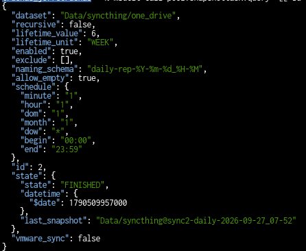

And if you want to query all used naming schemes on a system to not have to look into N² snapshot tasks.
midclt call pool.snapshottask.query |jq -r '.[]|[.id,.dataset,.naming_schema]|@tsv' |sort
Cool, thks for the note. Ive seen threads where some suggest it’s not good practice to use middleware commands, that they may be depreciated in the future. It works great for now.
only using, for example
