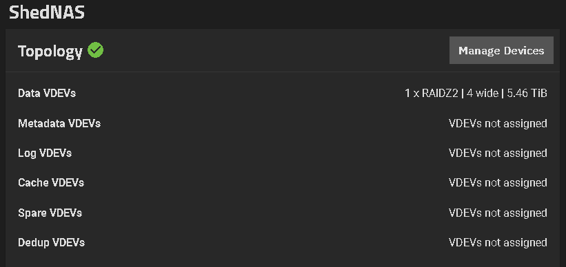

To date:
  1. Storage Dashboard - imported ZFS pool for xigmanas.
  2. Datasets - my dataset is present ShedNAS.
  3. Created User.
  4. Windows (SMB) Shares - Running.
  5. Windows (SMB) Shares - “Add” only shows /mnt as path location. Then produces the error message above.

Dataset
Under “Roles” icon to the LEFT “This dataset is used by the system”
More info
Under Datasets → Roles → Create SMB Share
Path auto populates “/mnt/mnt/ShedNAS”
Gives error message "[EINVAL] sharingsmb_create.path_local: The path must reside within a pool mount point "
