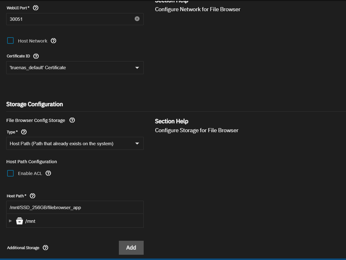

and here is the installation screen configuration details that i used while installing
Please guide what should I do to resolve it.
Truenas 24.10.1
filebrowser APP
Not only this app, but when i try to install any app same thing happens
