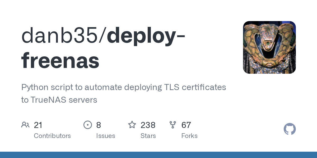

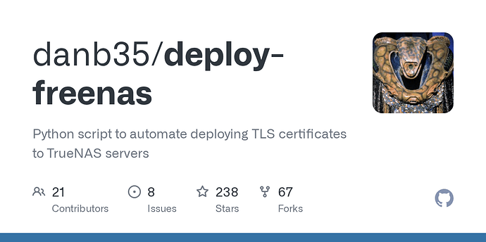

A popular option is Community Member Dan’s python script, but i don’t know if it supports http challange.

My script doesn’t directly support any challenge; it takes a cert that’s been obtained by some other means and installs it to TrueNAS.
Sure: get the cert using some other tool (like, e.g., lego or acme.sh), possibly on the NAS itself or possibly not, and then use another tool (e.g., my script or tnascert-deploy) to install it to TrueNAS. Here’s a guide for this process, though you’d need to adapt it a bit to use HTTP validation:
The basic work flow is:
  • Use your preferred ACME client to obtain the cert
  • Use the --renew-hook or equivalent option in that ACME client to call my script, tnascert-deploy, or some other tool to import the cert into TrueNAS
These steps can take place on the NAS or on a different system, at your convenience. If you aren’t doing this on your NAS, you may find tnascert-deploy by @jjrushford to be easier to work with than my script.
