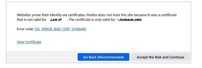

Hey everyone, went ahead and registered a domain w/ cloudflare, did the letsencrypt acme cert generation and all is validated. The problem is that I did not include the LAN address of the NAS on the cert chain.
I know normally you dont do that, but do want to SSL protect the NAS and apps running in it, like emby. Read the thread below:
but was not what I was looking for. This is the error in question:
Question is how do I add the LAN address so that firefox is happy? The *domain.org is just a generic name I am using, thats not my actual registered domain.

As for your second question, are you running a DHCP / DNS server that associates various internal FQDNs with the IP’s in question? If so, I suggest you try entering the FQDN into the address bar instead of the IP address. If you error does not persist then that was the issue.
IP addresses in reserved address ranges like 192.168.x.x, 172.16.x.x, 10.10.x.x cannot be requested for SSL. Lots of people may have a device that legitimately corresponds to 192.168.1.1, for example. That’s not the same as “router.YourFQDN.com”.
IIUC, you issued the cert but accessed your truenas via IP. To mitigate this security popup, you have to access your truenas via FQDN (the cert was issued for).
Assuming you issued a wildcard cert for *.domain.org, you just need to create an A record for truenas.domain.org that points to lan ip (of your truenas) in your dns server (cloudflare). Then you would be able to access truenas via this exact url.

That is correct, I issued it for the top level domain. I never thought about creating a local dns record, duh.

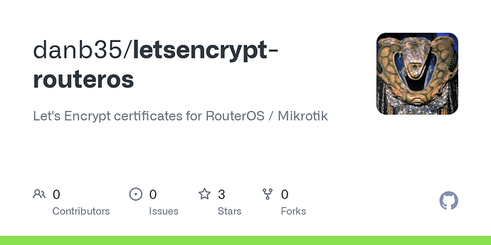

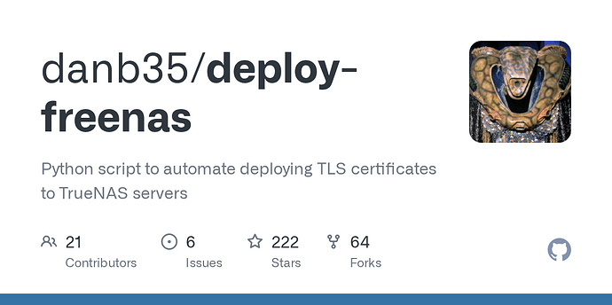

All my stuff is on my GitHub:
Specifically, to deploy a cert to TrueNAS:
To deploy a cert to Mikrotik:
