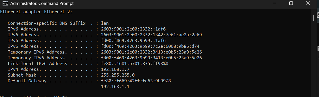

Ok here is a screen shot. I ran the ipconfig command and this is what comes up, is it the Ipv4 ip address I would use as a static Ip address. Thanks so much

The system you ran the command on has an IP4 address of 192.168.1.7 wih a subnet of 255.255.255.0, so you are on the 192.168.1.x network with that system which is likely your only system and the modem is handing out the addesses.
