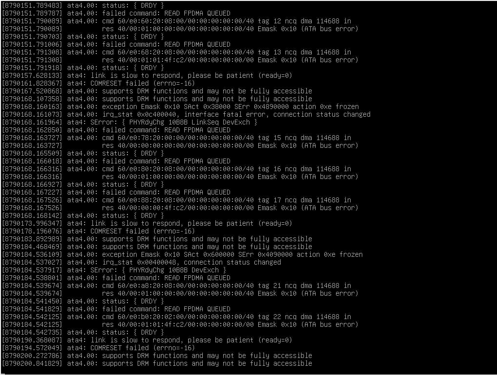

I didn’t took a screenshot but two disks were marked as unavailable and one as removed. In the console messages I saw some SATA connection(s?) degraded to 1.5 Gb.
I took a screenshot from the BMC. ata4 must be the connection where the disk is shown as “removed”. I shut the system down and opend the case but nothing unusual to see.
