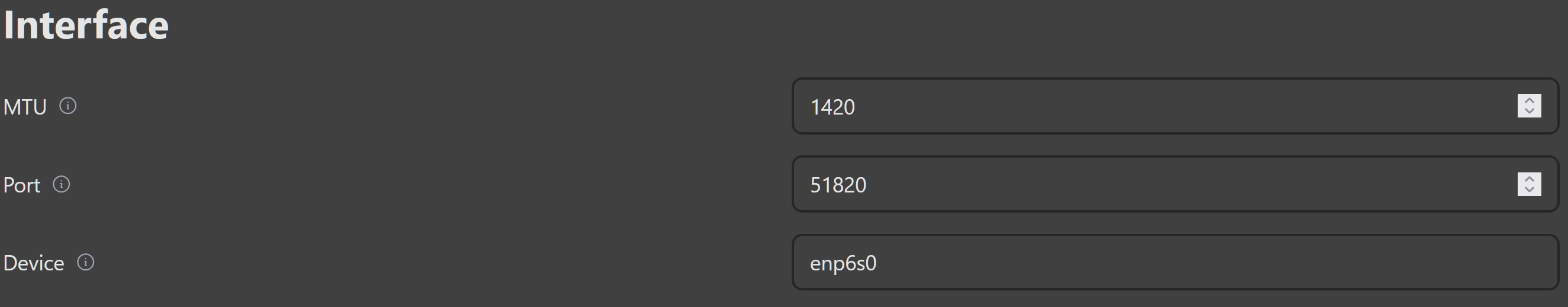

Definitely make sure that the correct interface is chosen in the wg-easy web ui under “Device”. eth0, the default, is likely not correct.
Allowing all IPs with 0.0.0.0/0 would be simpler and more elegant IMHO. It works in the same manner
In my case, eth0 was automatically set by wg-easy. After setting my real interface, enp4s0 all worked well \o/
