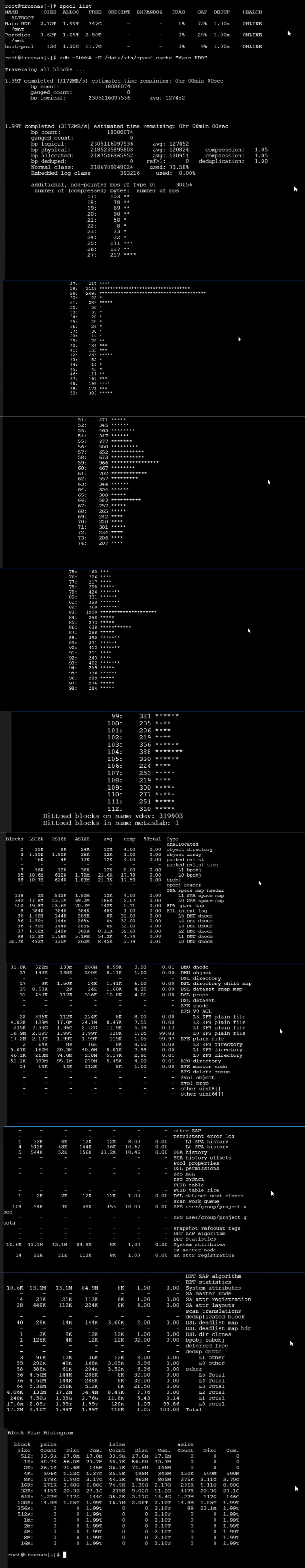

Please find the attached result of my pool, from the command “zdb -LbbbA -U /data/zfs/zpool.cache”. Command was used while I was on theTrueNAS Core, and I’m now on a TrueNAS Scale v24.10 (upgrade went well).
You could hardly make it LESS readable, couldn’t you?
All necessary information to read this long blurb is above:
You have 2.76 GB of metadata, which may very well fit all in ARC if the NAS has enough RAM, and most of the data is in 128k records.
You could easily have a sVDEV of 128 GB at 32k cutoff (29.1 GB now at 50% occupancy); 256 GB would be a bit tight for 64k (146 GB).
Really, for less than 4 TB of data you could drop hard drives, go all SSD and forget about a special vdev.
