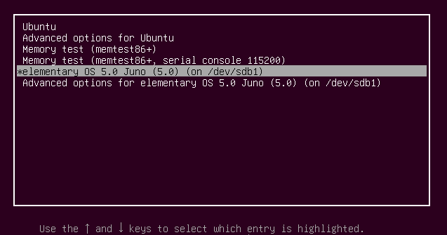

Some Linux distros include memtest as one of the options in the Grub menu.
Since TrueNAS SCALE/CE is technically Debian underneath, and it uses Grub, you can hold down ESC or Left Shift during boot to pause the menu screen.
This is what an Ubuntu Grub menu looks like. They include memtest by default.
