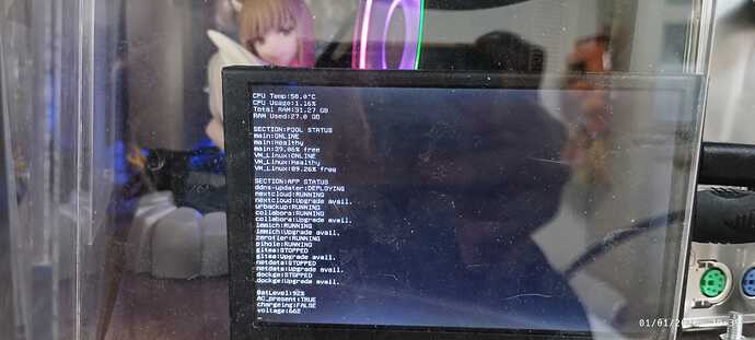

update:
thankyou @oxyde for his python script so i can do this curse thing on my NAS
still, warning, do not attempt, if you really want to do it, test it on a VM first, but there is no guarantee that it won’t cause data lost
