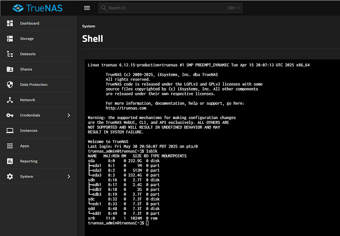

Well, the good news is that I got the T110 up and running with an SSD disk for TrueNAS, 2x8TB drives and 2x3TB drives. Further, the 8TB drives are now mirrored, which is what I wanted.

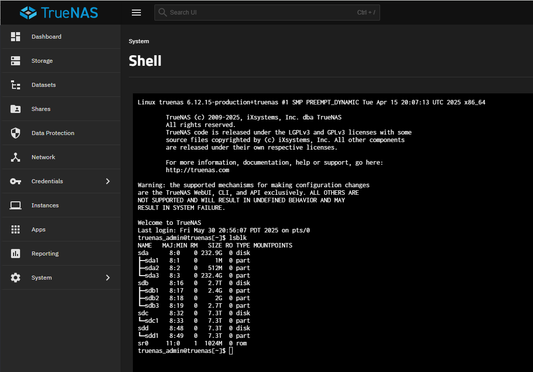

Alas, one of the 3TB drives is not available to TrueNAS:

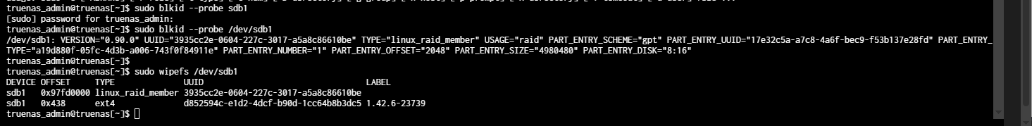

It looks like there is a RAID partition from the previous owner, but my Un*x is rusty - how do I remove those partitions on sdb1 and sdb2 and make the rive available to TrueNAS?
Then there is the issue of how to connect to the TrueNAS system from Windows - I suspect there’s a step I am missing here. TRUENAS is visible from windows, but I can’t connect to it, presumably because I need to send it authentication. But that’s for after I get the disks up and running…
You can always nuke the partition table with zeroes; something like
sudo dd if=/dev/zero of=/dev/sdb bs=1M count=40
Breathe slowly, deeply, and triple check your command before hitting Enter…
But first, look whether there is a “Force” tick box when manually adding a drive to a vdev, or a “Wipe Disk” button, somewhere.
