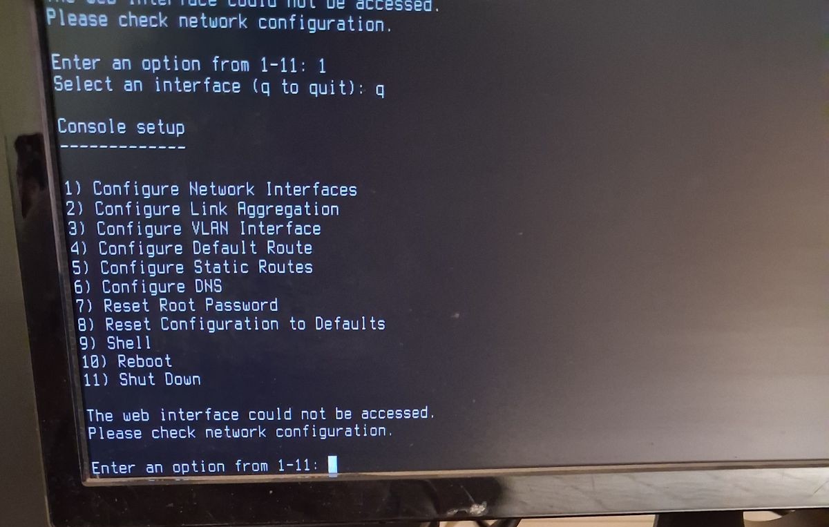

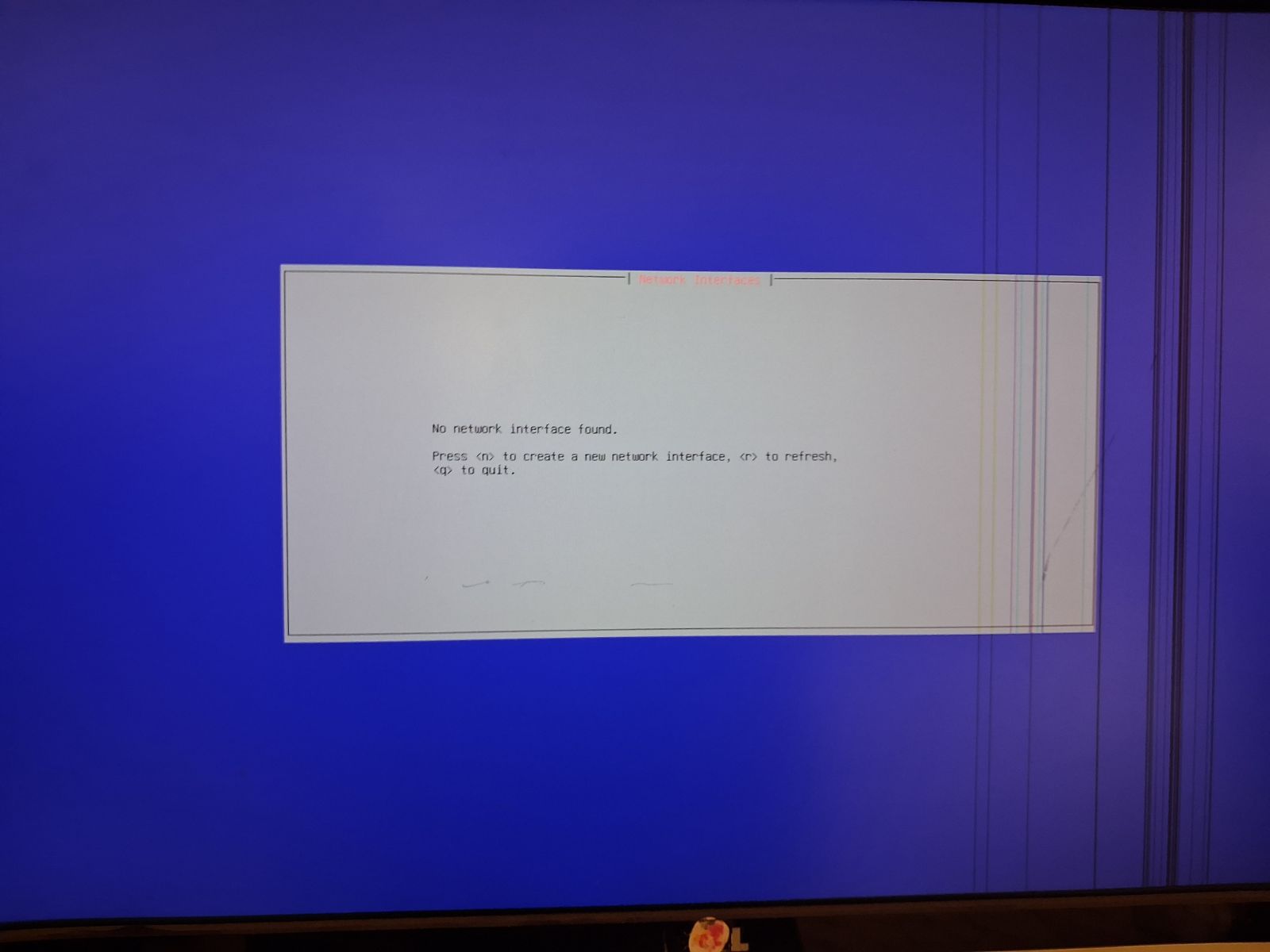

Hello, everyone, so we have a GIGABYTE Motherboard GA-B760M DS3H, and we installed the TrueNAS scale on it, but it shows that the web interface could not be accessed. We tried installing a different OS (Windows) to check whether it is a hardware failure, but no, the internet is working just fine. Yet the TrueNAS detects no network interface. Does anyone have any solutions for this?

okay, so the cable is cat-6 and the thing is during installation, I didnt see any setup to choose IP address. But i can say you that in the truenas shell, ip a resulted in only ‘lo’ details. The truenas absolutely detected no network interface.
This likely uses the RTL8125 chipset which AFAIK doesnt work yet on Truenas 25.
