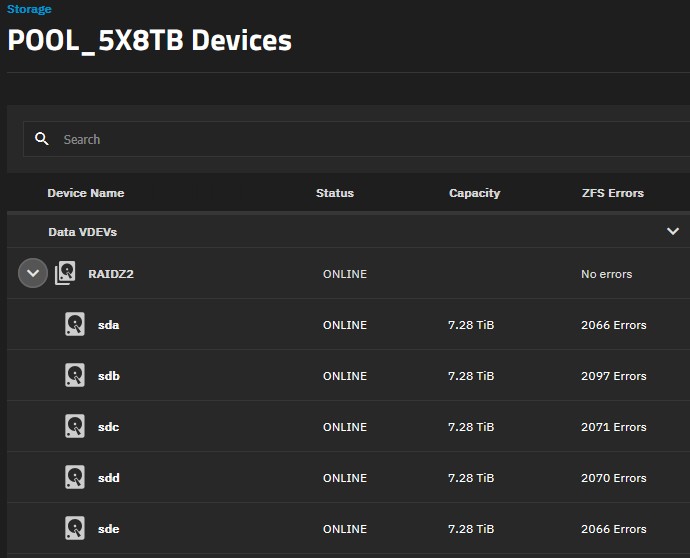

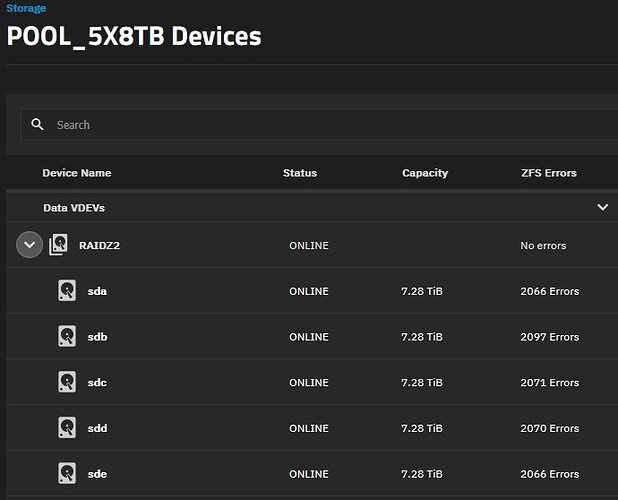

I did a zpool clear last night with a clean reboot. Below is the current state of the drives this morning.

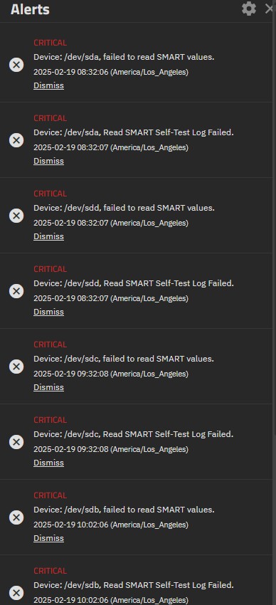

I also see SMART errors on multiple drives.

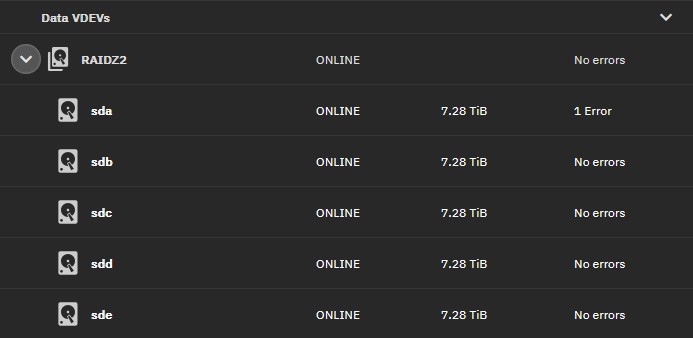

I am still seeing disk errors on different disks:
I also continue to see SMART failures for different devices.
I have tried running the LONG SMART test with the following results:
sda: Aborted 4 times
sdb: Aborted 2 times, then Passed
sdc: Aborted 5 times
sdd: Passed first time
sde: Aborted 1 time, then Passed

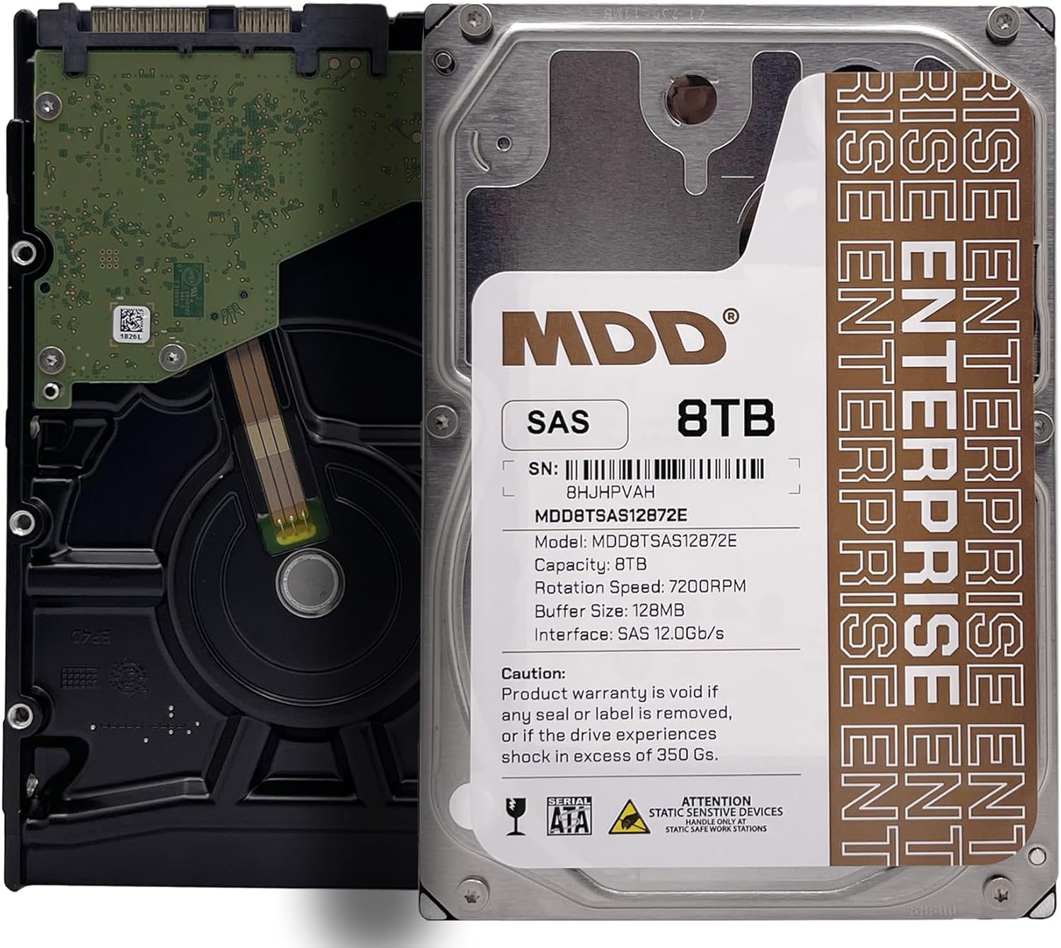

Those drives have like a 14% 1 star rating on amazon, possible the drives themselves are the problem?
@Craig_L - you may very well be correct. The drives were fairly inexpensive.
This is the actual model # I purchased: MD8TSAS12872E
I see 5 stars here, but only 2 reviews:
I see this drive listed here as ‘top 5’ with a 9.3 rating
I am almost at the point of pulling the trigger to purchase new drives. I just hate to spend several hundred dollars without being to fairly definitely proved the drives are the problem.
If I purchase new drives, I will go SATA vs SAS. My backplane supports either. I was hoping for some benefit from 12GB/s vs 6. As mentioned, the price-point was also attractive.
Any recommendations on good 8TB SATA drives for a NAS?
Not sure I had the right listing, but on amazon.ca, that brand has pretty bad reviews. Basically refurbished drives.
Backblaze publishes their drive stats every 3-4 months. I’m using WD 18TB Red Pro drives in my NAS.
I am pretty sure that MDD/SexPanther/WhateverOtherRandomName drives are just used Seagate/WD/Toshiba drives with a new label and the smart stats wiped. This is likely why you’re getting errors about retrieving SMART data.

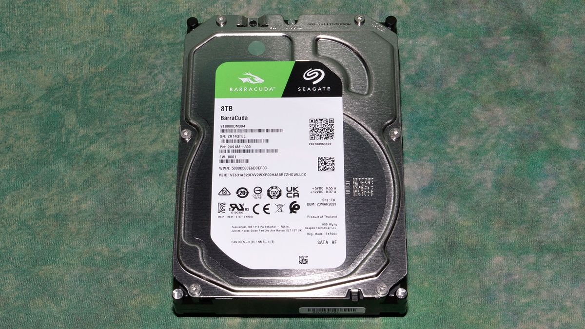

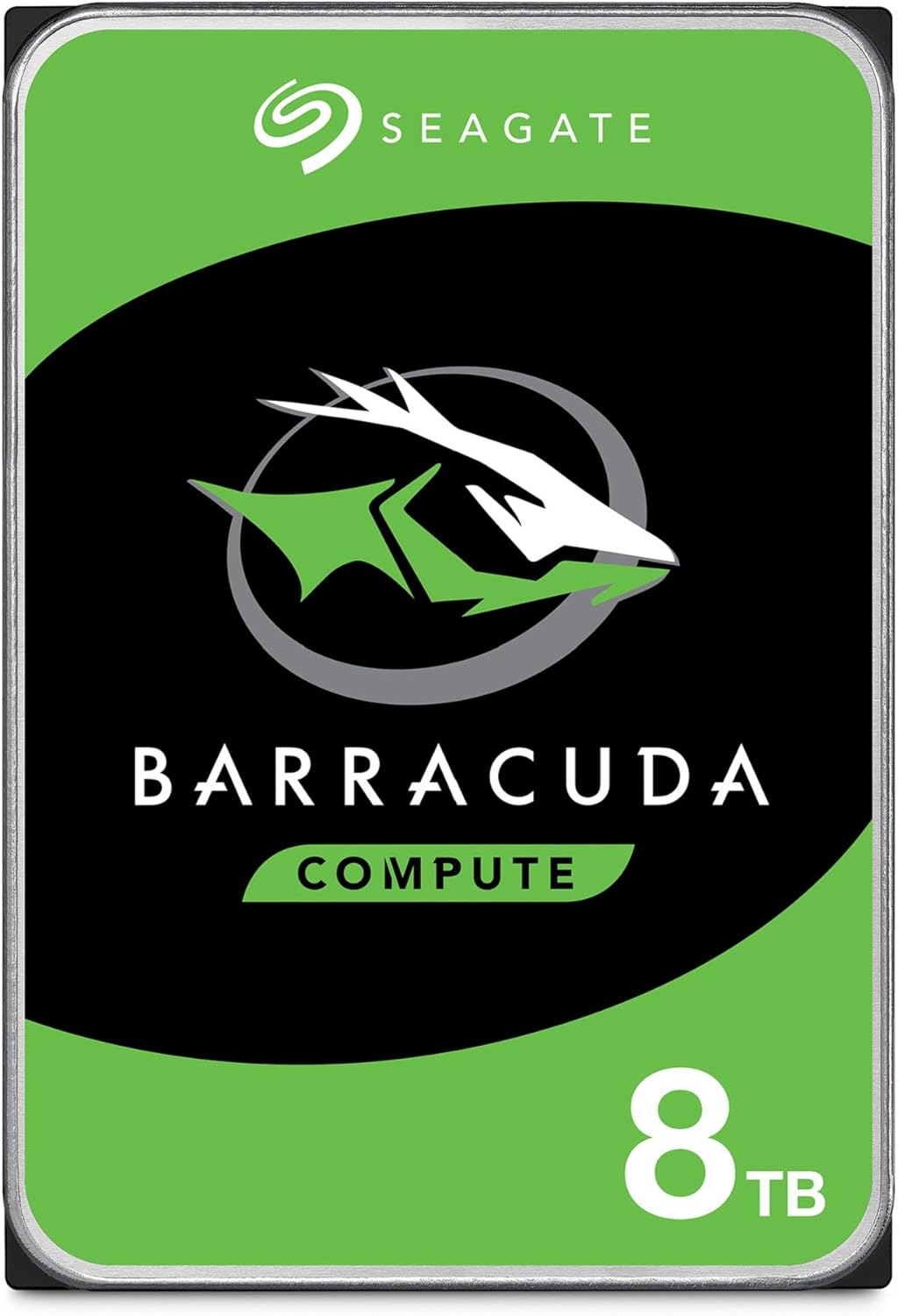

Any concerns with 5400 RPM drives vs 7200 RPM?
These seem reasonable, and plenty of good reviews.
This also seems like a decent deal for renewed with 5yr warranty.
Barracuda most likely SMR and not suited for use with ZFS / TrueNAS.

You definitely do not want SMR drives.
Between those two, even if the Barracudas were CMR, I would still choose the Exos. I have no experience with buying ‘renewed’ drives and have only bought ‘manufacturer recertified,’ but they are enterprise drives with a longer warranty from gohdd.
