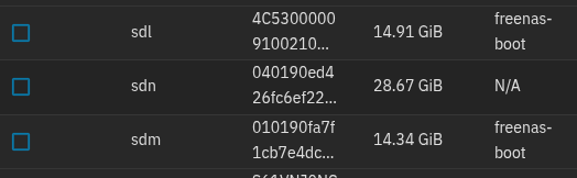

I’m seeing the same issue but with non-duplicate short serials, reported as serial ‘none’ and conflicting when I try to add a new VDEV to any pool (not just the pool containing these drives). Both drives are SanDisk usb keys, attached of course via USB, and make up a mirrored boot pool.
Currently on 25.10.1. Happy to provide any additional information that would be helpful!
root@nas[~]# udevadm info --query=all --name=/dev/sd{l,m} | grep -i serial
E: ID_SERIAL=SanDisk__Cruzer_Fit_4C530000091002109050-0:0
E: ID_SERIAL_SHORT=4C530000091002109050
E: ID_USB_SERIAL=SanDisk__Cruzer_Fit_4C530000091002109050-0:0
E: ID_USB_SERIAL_SHORT=4C530000091002109050
E: ID_SERIAL=USB_SanDisk_3.2Gen1_010190fa7f1cb7e4dc6c3ff2bbe3e4872a1afd10dfef2ac0a429acd64f487496cbd700000000000000000000fa7fdc25009c0b008355810741b0d9da-0:0
E: ID_SERIAL_SHORT=010190fa7f1cb7e4dc6c3ff2bbe3e4872a1afd10dfef2ac0a429acd64f487496cbd700000000000000000000fa7fdc25009c0b008355810741b0d9da
E: ID_USB_SERIAL=USB_SanDisk_3.2Gen1_010190fa7f1cb7e4dc6c3ff2bbe3e4872a1afd10dfef2ac0a429acd64f487496cbd700000000000000000000fa7fdc25009c0b008355810741b0d9da-0:0
E: ID_USB_SERIAL_SHORT=010190fa7f1cb7e4dc6c3ff2bbe3e4872a1afd10dfef2ac0a429acd64f487496cbd700000000000000000000fa7fdc25009c0b008355810741b0d9da
