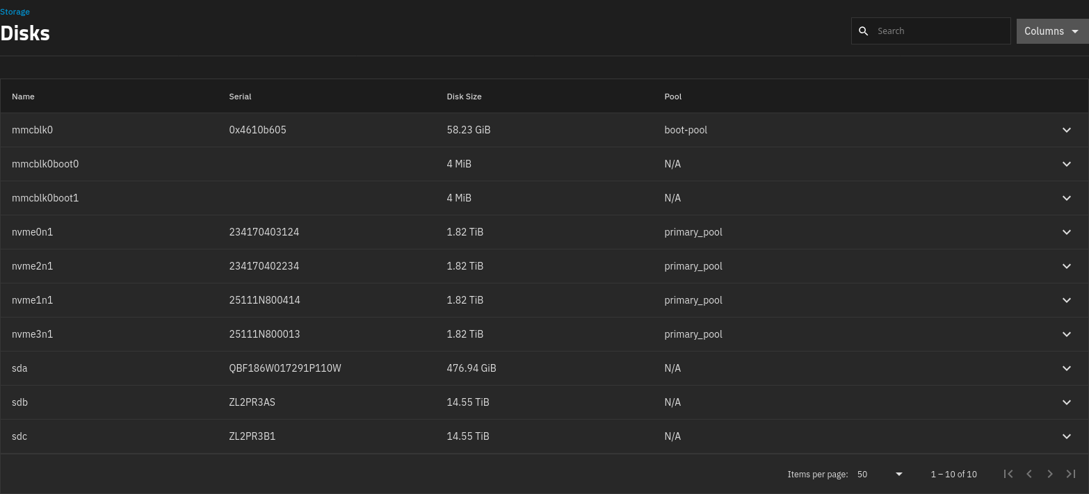

How it looks in UI, then? Perfectly fine. See last three drives sda, sdb and sdc:
It’s possible to wipe the disks from this screen. I have wiped the SSD and new HDDs. Works fine.
