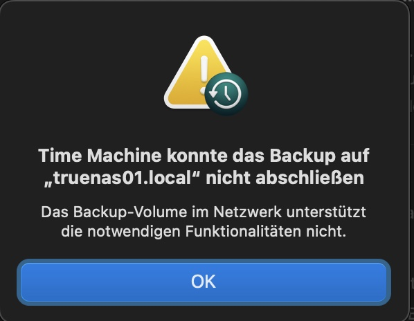

after install the Update from 24.10.2.1 to 25.04.0 Time Machine not working.
App not find the Time Machine Share from TrueNAS.
When i switch back to 24.10.2.1 Time Machine Share is found and Backup running.

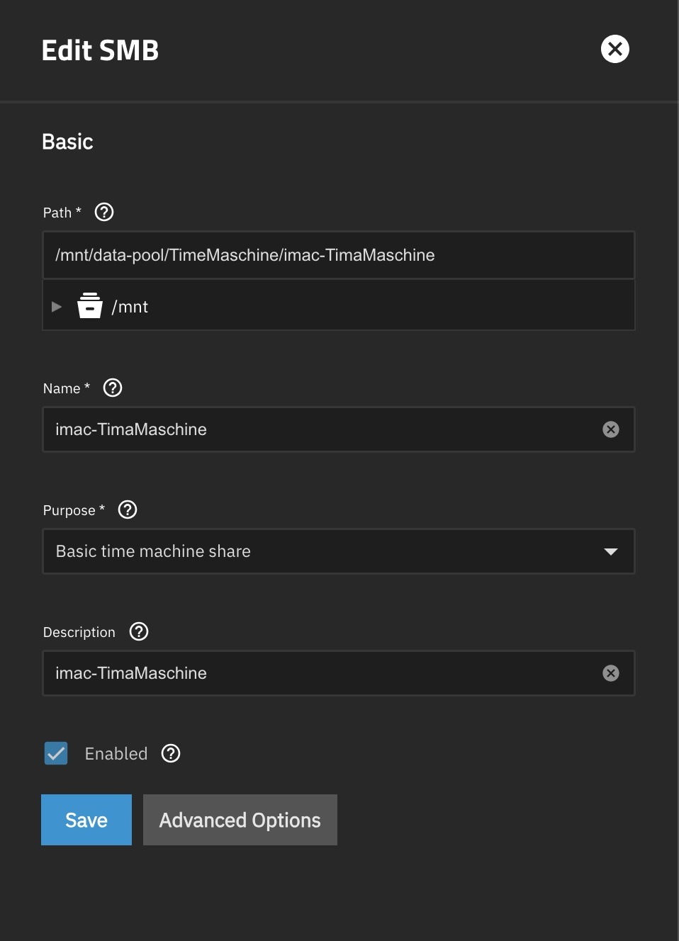

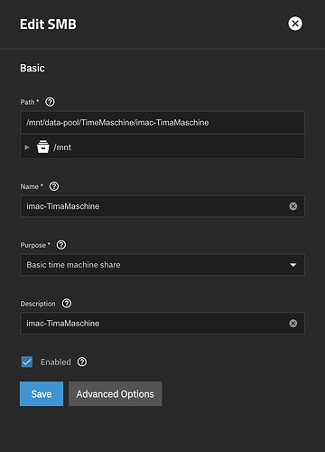

No, is only a Basic Time Machine Share
The Error is:
I think the issue that’s been reported is that Time Machine shares will stop working if any other share on the server is configured for mixed SMB/NFS use. This was a known issue at least during RC1, I think.
