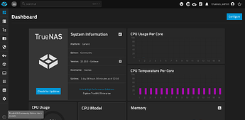

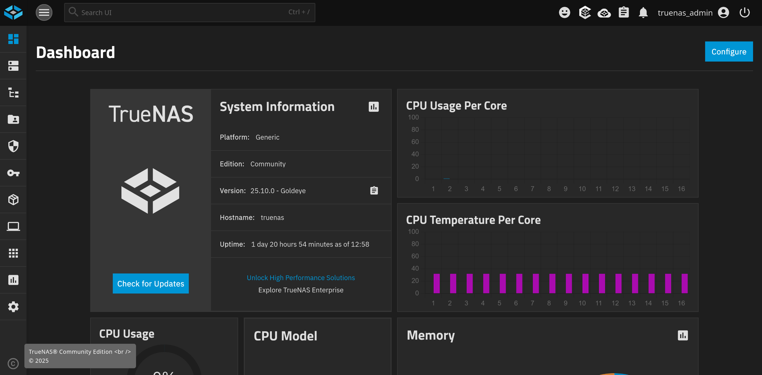

Just a minor issue. After toggle collapse I noticed:
<br />
at the bottom just hovering the icon.
