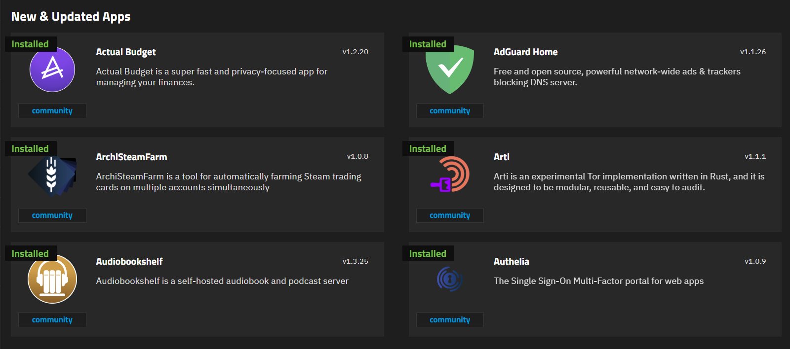

look at this. those apps I never installed, don’t have them but it shows they’re installed :slight_smile:
after few minutes not any more…
tried installing Chia, uninstalling and installing deluge. both work, other apps not…
