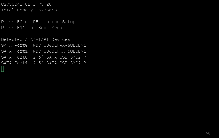

TrueNAS Mini POST hangs after power cycle at A9 instead of Setup or Boot
My stalwart TrueNas Mini does not start correctly after power cycle.
Note the A9 below, normally we should get past this quickly, to the Setup screen if F2 is pressed, or to EFI boot if left to its own desires.
C2750D4I UEFI P3.20
Total Memory: 32768MB
Press F2 or DEL to run Setup.
Press F11 for Boot Menu.
Detected ATA/ATAPI Devices...
SATA Port0: WDC WD60EFRX-68L0BN1
SATA Port1: WDC WD60EFRX-68L0BN1
SATA Port0: 2.5" SATA SSD 3MG2-P
SATA Port1: 2.5" SATA SSD 3MG2-P
                               A9
For POST A9 error, I remove the CMOS battery, shorting it briefly, & replacing it. I have twice inserted a fresh tested battery, and repeatedly hit the same issue.
After resetting CMOS it’s necessary to reconfigure the BIOS to regain access to SOL (remote serial console over IPMI) , which I’ve done via VGA + USB keyboard, including setting up the SOL again.
After doing this, I have to disconnect the power supply to put the case back together and then it hangs at boot at exactly this spot every time.
Pressing any of F2, Del, F11, makes no difference.
Any ideas what can be done? What is it doing at the end of A9 when it should jump into either booting, or firmware setup?

thanks for the suggestions Joe.
We are connecting the 2 sides of the CMOS battery slot not the battery itself.
  1. yes
  2. it has run for several years without intervention, with occasional SOL use for power on / off mainly.
  3. plenty of that, yes :slight_smile: probably a little too much for my liking, the reboot lag is annoying.
  4. I have found that I can get past A9 if:
  • we have no extra NIC installed
  • or, if the PCIe > 4G BIOS setting is disabled
So I have no idea what the previous settings were, but that PCIe setting is the culprit here.
