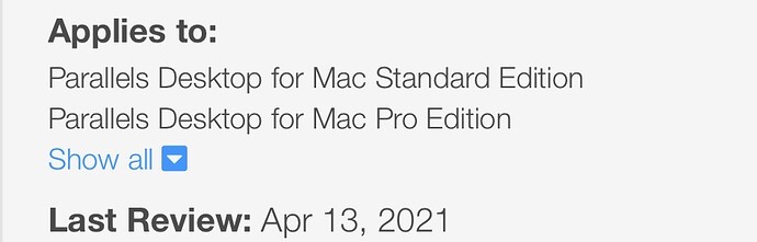

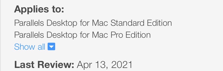

This appears to be a dead end: parallels does not seem to allow pass through of a random pcie device: KB Parallels: Firewire/Thunderbolt device is not working in Parallels Desktop
Careful, that article refers to a edition of parallels from some 4 years ago
There is this series of posts from 2023 suggesting that external thunderbolt-connected storage is supported (but likely only as a DAS, not HBA). It links back to the 2021 article you referenced as well.
Sadly, I fear you’re right though. A HBA running on thunderbolt is unlikely to be “seen” or usable by parallels.
