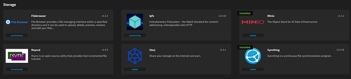

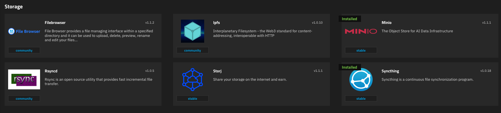

You have access to docker with dockage and portainer so you can install file browser through this.
FileBrowser is already included
The list of Electric Eel Apps and status is here;
In the case of Filebrowser… it is marked as available.
It is not marked as migrated… so will not automatically migrate from Dragonfish.
