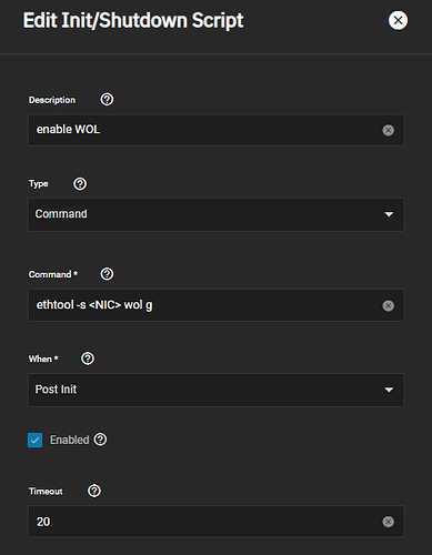

May you have to add an init/shutdwon command under system - advanced. At least that solved problems I had with a server that would not wake on lan.
I do not need it any longer, but I think I found it on the old forum.
Edit: I think it was this
Hey, great idea, small problem though, i tired running the command in the Shell, just to find out i do not have ethtool install. when trying to install it trough the Shell the Shell gives back that i cannot install anything using the Shell (has been deactivated in TrueNAS) so how am i supposed to install ethtool?
sorry my mistake, you HAVE to write sudo in the shell! sorry

Just wanted to confirm that I was having the same problem with Wake on LAN not working and your post solved it for me! Thank you!
For anyone else troubleshooting WOL or may be a beginner when it comes to Linux here are some tips. Remember to use sudo first in the TrueNAS shell or from SSH.
To list your network devices:
sudo ifconfig
NICs will appear listed enp1s0, enp2s0, eth0 or similar etc.
This is what you put into the example above.
To test if your NIC has WOL enabled you can run:
sudo ethtool enp1s0 | grep -i wake-on
If its active it should say something like:
Supports Wake-on: pumbg
** Wake-on: g**
If its not active you wont get any output.
To manually enable WOL:
sudo ethtool -s enp1s0 wol g
Then re-run the previous command to check that it sticks.
To have it be re-enabled after reboot though so you need to create a Init/Shutdown script as instructed by prez02 above. If your NIC device name is enp1s0 your command to enter into the init/shutdown script will be:
