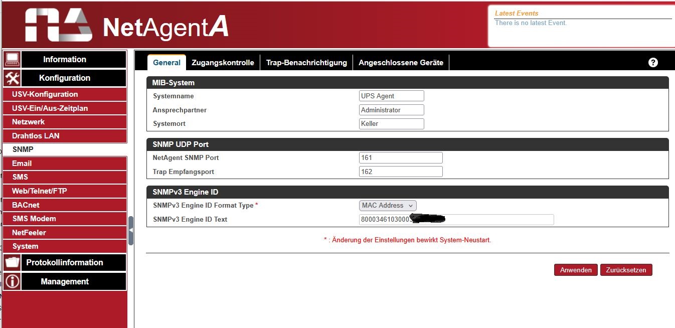

But I still get it not worked that while my NetAgent UPS send a Trap (SNMPv1, community name, port 161 or 162) the TrueNas is shutting down. No matter which configuration, no matter which kind of driver… I’ve got ethernet, as well as USB connection. command: /usr/bin/midclt call system.shutdown “UPS-batt_shutdown” will not work…

nothings works with this “Netagent” SNMP-adapter (as it lost configuration because of ram failure).

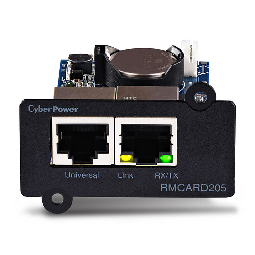

And I do not understand how you can pick pone of two different brands of SNMP adapters? Network management cards come from the UPS manufacturer and are specific to the UPS in question. E.g. something like this for Cyberpower:
