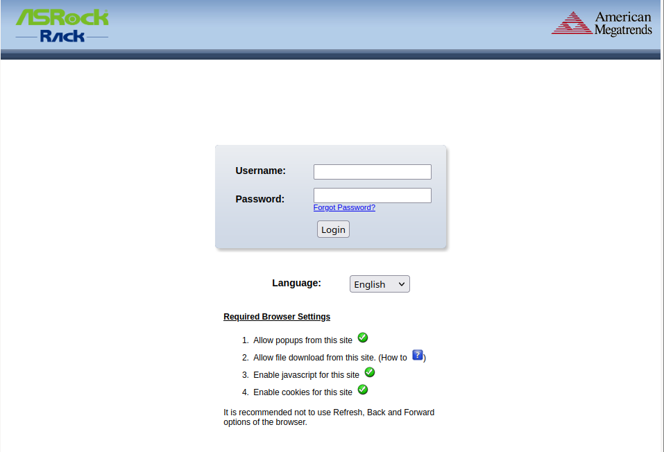

Truenas stopped being accessible and instead has a Megarac ASRock login
A few months ago my TrueNAS setup stopped resolving, and is instead now loading the Megarac login screen instead of TrueNAS.
This happened previously when it was FreeNAS and I can’t find any information on how I previously fixed it. It has obviously become incredibly frustrating since nothing on the network can communicate with TrueNAS at this time.

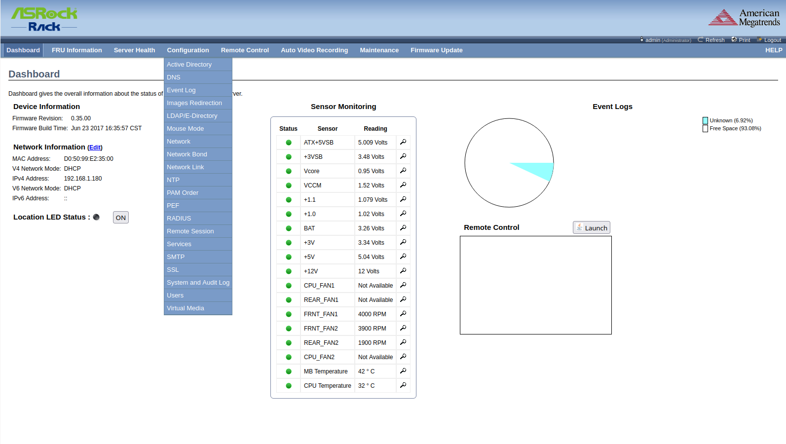

The hardware is a FreeNAS Mini-XL. Below is a screenshot of the login screen that gets served when accessing with web browser. Any suggestions or help? Thank you much.

I can get into the IPMI but I don’t see anything that allows me to fix the situation. There isn’t any access to BIOS, but there is a “Network” tab. I have flipped through all of the settings but I am not seeing anything that jumps out as to where I should start. Any suggestions?

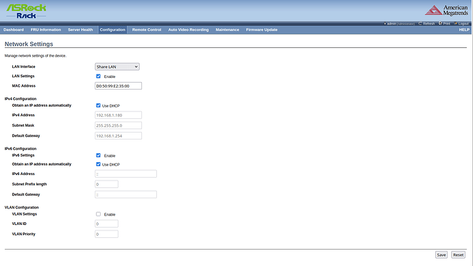

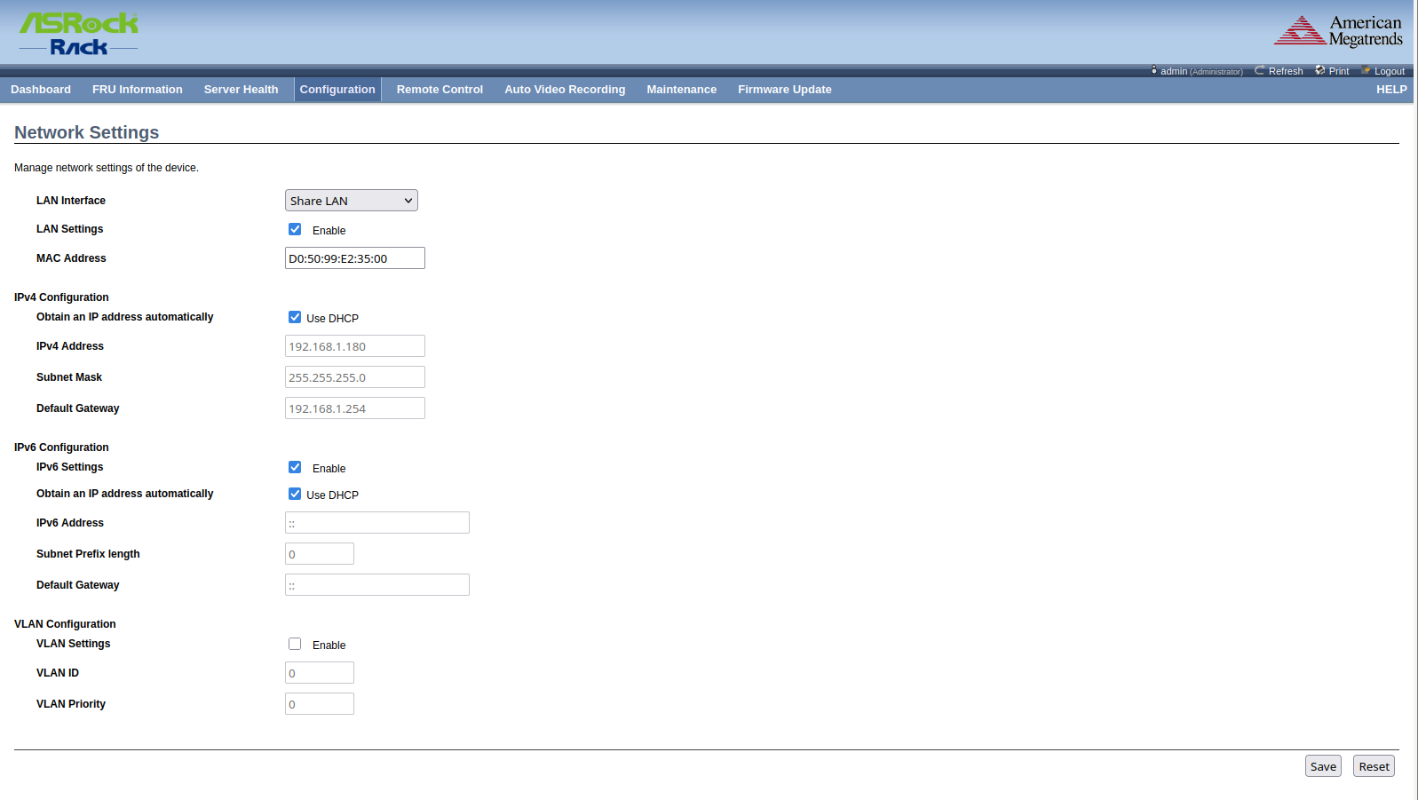

The IP address & the mac address in that tab, is that the same ip and/or mac you’re expecting to use for truenas? If so, that is why you have a conflict
I don’t remember what the MAC address was when it was working, but the IP was x.x.x.181 as opposed to the x.180 that it is now. This is what the ‘Network Settings’ page looks like. I am wondering if the Share LAN should be Dedicate LAN, but all that seems to do is allow me to enter the IPv4 configuration manually, not really set TrueNAS to an Ethernet port.

Have you verified what the server attached display shows when you have the server on? You know, the one listed for the web interface when the server has fully booted up, above the numbered menu.
It should list the IP TrueNAS will listen to.
I say this because even if you have Share LAN selected, the IPMI should not use the same IP as the OS (just the same physical interface), and by all appearances you are accessing the IPMI IP.
