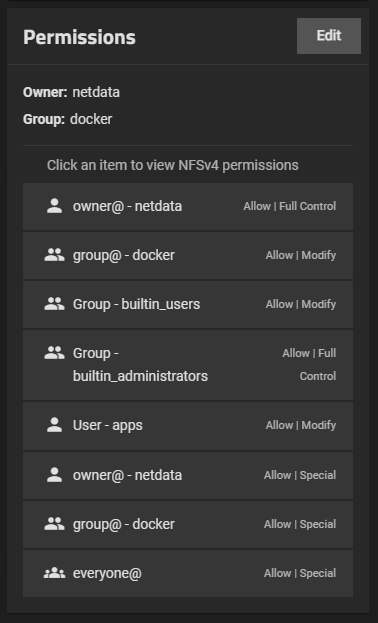

postgress needs permissions for unix user 999
Yup, I mentioned in the original post, 999 has permissions already. Here is the permissions for the dataset

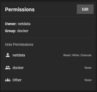

Try creating a new dataset with the generic preset, don’t set up an acl, and then check Automatic Permissions
That might be it, I see this. How did I do that? How do I change it to unix?
Creating a new dataset worked. Did setting an ACL change that from Unix?
Potentially or you used a preset that defaults to NFSv4 (the apps preset would, for example)

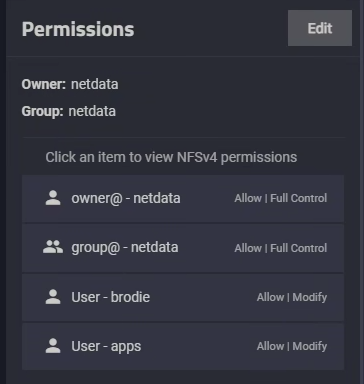

Ok actually I just did a few test installs and it looks like it wasn’t the ACL type but I think the fact that your initial dataset contained an ACL already may have been preventing the Automatic Permissions chown from working.
Both of these are working installs, with permissions set automatically, so I think as long as you keep the Owner and group as 999:999 (netdata:docker) you should be good to add your user.

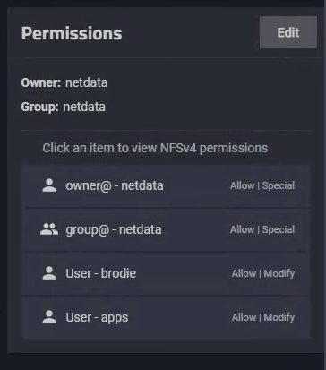

I added myself, once I did when “postgres_upgrade” starts it’s reported as “creashed” with
cat: /var/lib/postgresql/data/PG_VERSION: Permission denied
