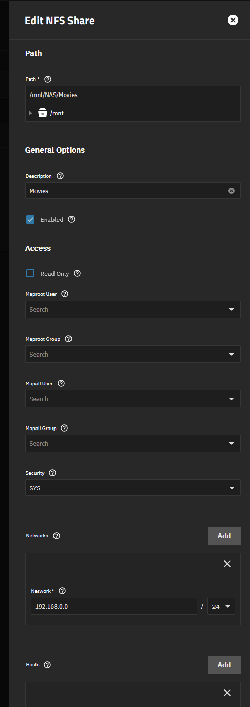

my share looks like this on truenas , my PC IP is 192.168.0.10

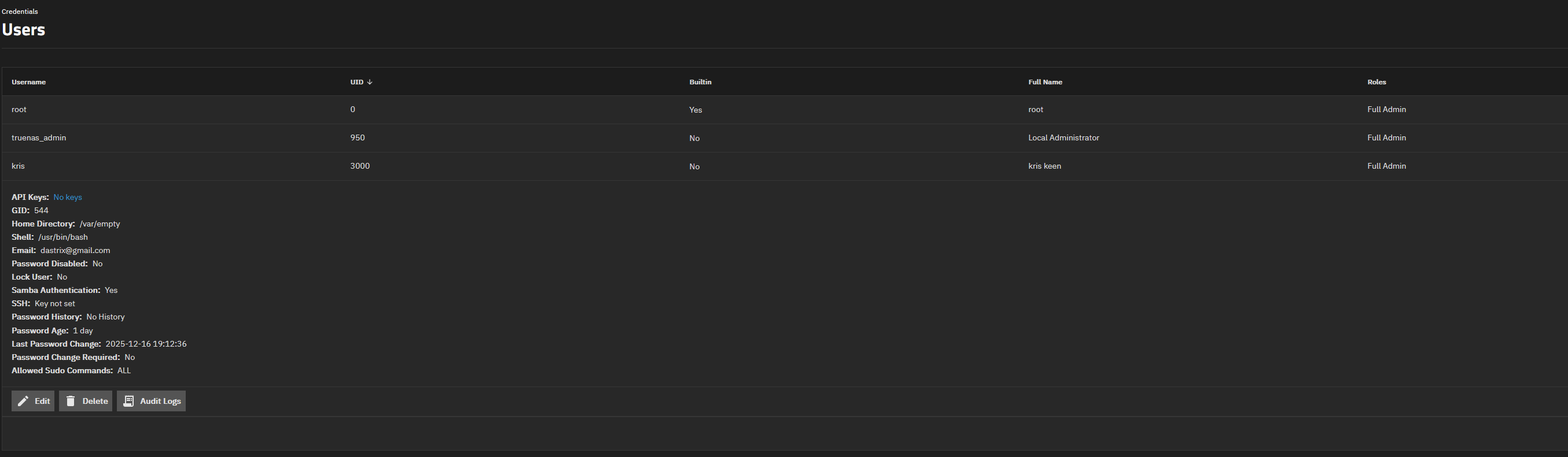

Here is my user config on truenas, windows also uses ‘kris’ as my username
Share works perfectly via SMB. Fails via NFS with
