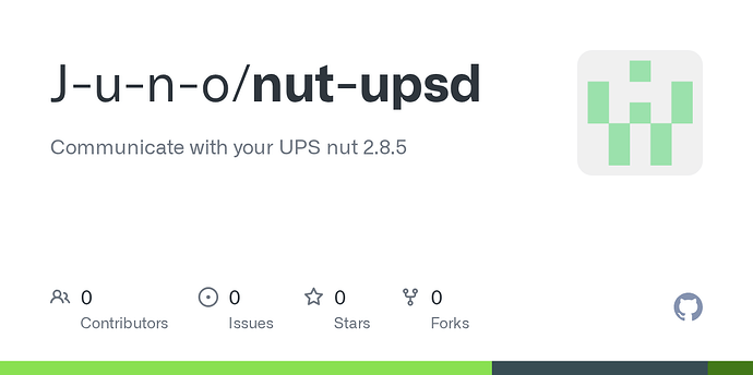

Struggled for myself to get it working. Started using a (present) docker, secondly got a script, so NUT inside Truenas itself got upgraded, I got this not working as well…
And I didn’t like ‘patching’ Truenas itself.
So forked a docker project and created a docker image accessible from github/lab.
Must admit I run the docker containers from the shell…
Setup the Truenas UPS service, and tested ok.
