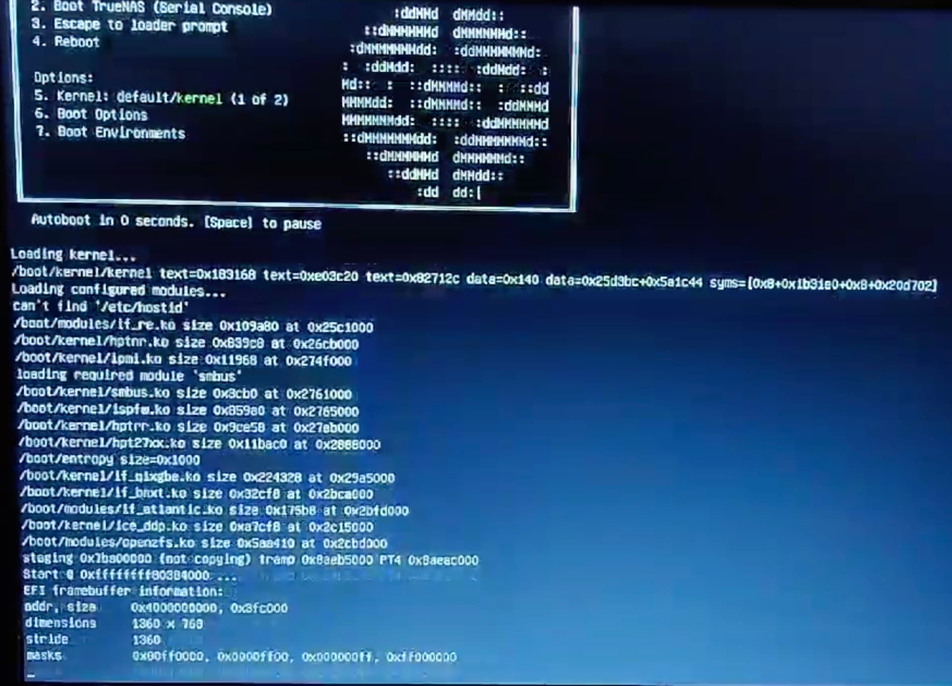

For a few days now, for no apparent reason, and excluding system updates, my TrueNas Core NAS has been unable to boot.
The boot does not complete and at the end the system tries to reboot and enters an infinite loop.
I’ve attached the screenshots I was able to take during the start-up.
It doesn’t really speak to me, even though there seem to be errors, but perhaps it will evoke something for some of you.
The aim is not necessarily to restart my NAS as it is, but rather to find a way of recovering my data.
Thank you for your for your help !

Here are the screenshots of the start-up that failed … :
Continued and finished…
The last screenshot precedes another system reboot.
Thanks for your help
Looks a lot like a failed or failing boot device.
Thanks dan for your help :+1:
Since I have two boot disks, perhaps I could try booting with just one of them?
And how can I repair the faulty disk?
You definitely could try removing one and booting from the other. If that fails, swap them and try again. If it boots successfully on one, run a scrub on that one, and consider the other one failed. Replacing it with a new device would be recommended at that point.
