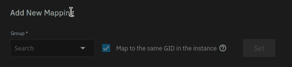

Here is an issue I am facing under 25.04: I’ve removed GID mapping for apps (568) by mistake in Incus (while removing other mappings).
However, I’m not unable to re-add that mapping.
When selecting the “apps” user, I get the following error:

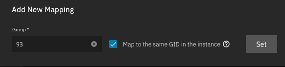

Also, what’s weird is that after I close the dialog, and sometimes before, “apps” will change to 93 on its own.
Is there a way to change to restore the defaults any other way?
Is this a bug or intentional?

To illustrate. It just does this on its own:
Kooha-2025-04-21-22-10-11

Odd, I’m seeing that too and only for the apps group (not user) as far as I can tell. Make sure you mention both issues in the bug report and add the ticket to your comment when it’s available.
