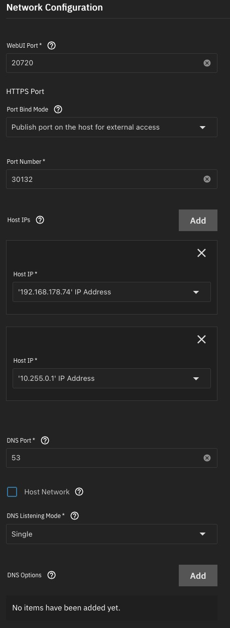

What are your settings under pihole here?
This is my config:
It looks like that I can select existing external host interface IPs for the management access (each HTTP and HTTPS with a specific high port to avoid confilcts with other GUIs) but for the DNS listener it takes all (0.0.0.0:53) for both tcp and udp. In other words, the configGUI is a bit missleading…
For my understanding docker will allow to restrict the listener to a specific host IP (as it does for the pihole management access), but for port 53 it is not implemented in the current pihole app.

erwin
