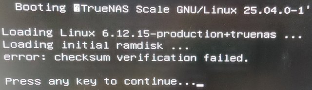

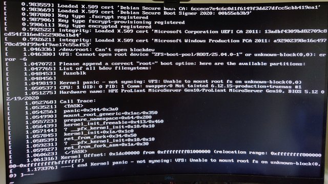

Upgraded to 25.04 from 24.10 - fails to boot

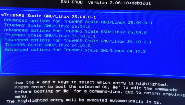

Performed an in-place upgrade within the web UI - changing train from TrueNAS SCALE ElectricEel 24.10 [release] to TrueNAS SCALE Fangtooth 25.04 [release].
Default GRUB entry set to 25.04.0:
Resulting in error: checksum verification failed:
Resulting in Kernel panic:
On restart, changing GRUB to use 24.10.2.1 restores the system to a functioning state.
This is a on a HPE ProLiant MicroServer Gen10 - BIOS 5.12.

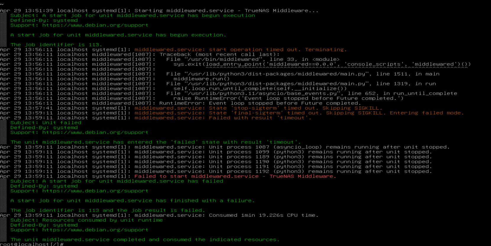

i have a similar issue with HP Proliant ML310e GEN8>
When booting 24.10.2.1 ( Fresh Install) it is all ok
When booking 25.04.0 (Fresh install) I get middleware unable to start
i have tried to delete the log files but this is a new install so the log file should be small
This is the log from journalctl -xeu middlewared.service
middlewared not starting is an issue for me and several others. I don’t work for iX, but I suggest you review this bug report: Jira
FWIW, I get the same python messages.

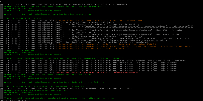

Hi @Kelly_Leavitt, @craigywsm
Did you find the solution for middlewared issue?

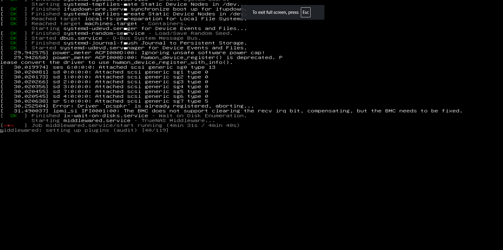

I just upgraded TrueNAS Scale from 24.10.1 to 24.10.2 and got the same issue shown by @craigywsm in the screenshots, with the same Python messages.
I tried looking on Jira ticket suggested by @Kelly_Leavitt ,NAS-135520, but get an message “You don’t have access to this ticket.”
Looking for jira tickets about middlewared bring some old ones, did not find there sufficient inputs
I had no problems when I updated to 24.10.2. I had a problem once I tried to get to 25.04. I have been informed that there are a lot of changes to the middlewared startup coming in the next 25.04 release (due 5/27/2025).
In the mean time, you could try to delete or rename fhe files in /audit and then doing the upgrade to 24.10.2
Thank you so much!
renaming files in /audit helped.
For my instance this is now fixed by upgrading to 24.10.2.2 and then upgrading to 25.04.1
The latest release 25.04.01 worked. I’m now up to date.
