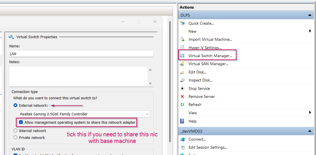

From the details given here , you are using a bridge network from hyperV. My suggestion would be to start with creating an external switch in hyper-V. If you have a dedicated nic to spare for this vm alone, you can keep it like that , if not, you can set it up to share the nic with base machine.
Yes, I’m currently using bridge network from Hyper V.
I’ll create an external switch with a shared NIC with base machine (another NIC is on its way from Amazon), and I’ll see if its’ works.
Thank you very much !!

and its not working ( I’ve created the External switch (with current NIC), changed the switch setting to External for TrueNAS VM. And as soon as I’ve changed the setting the TrueNAS connection is gone and “host is not found”.
If I delete the external switch from TrueNAS VM settings and delete it from switches everything comes back to normal.
Same with internal switch.
