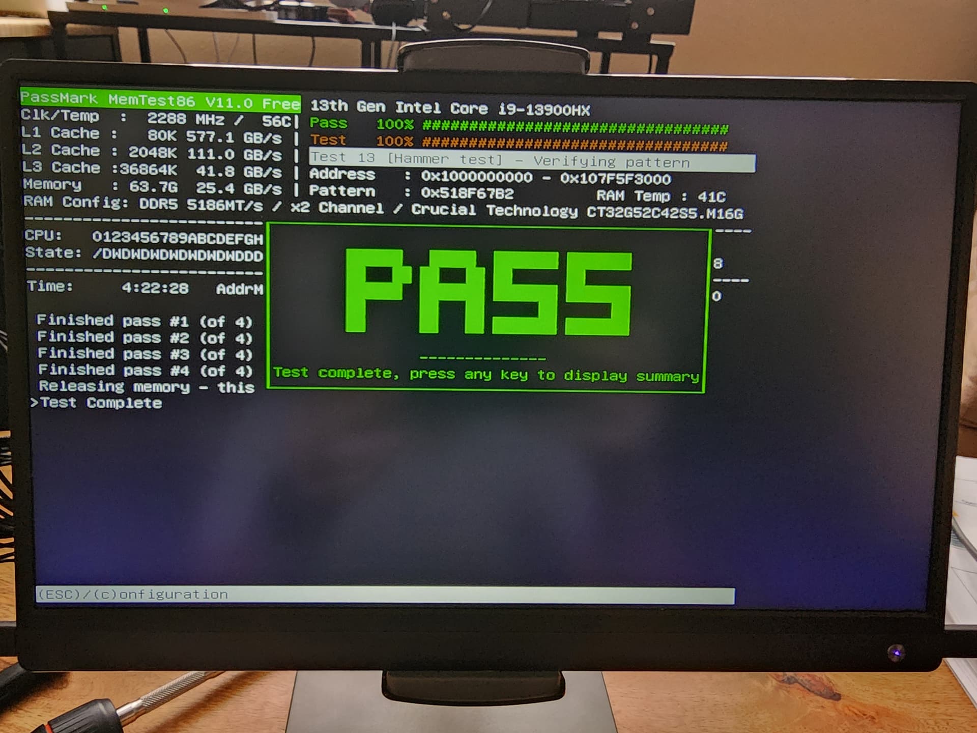

Have you verified that the RAM is okay with something like memtest86?

Havent tried a memtest yet, but Ill try that now

Memtest86 passed with zero errors
