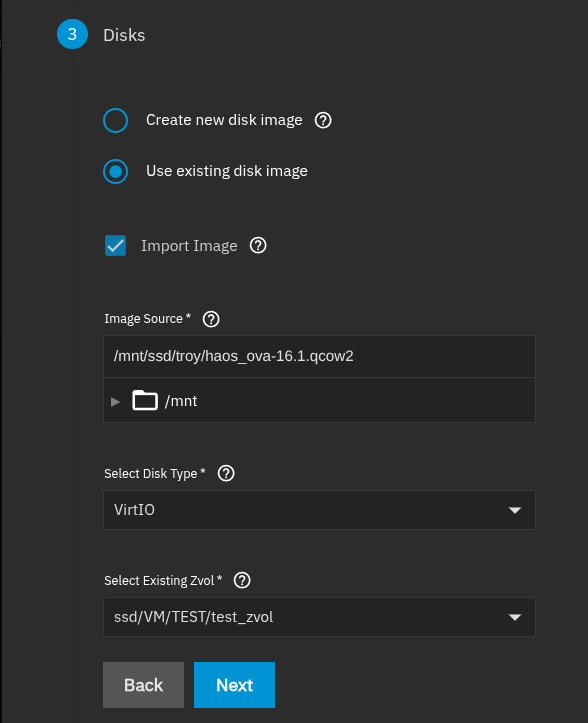

I don’t think the error has anything to do with installation media. Would you share a screenshot of the disk section after you have entered the necessary information? I don’t have any .vhdx images, but I tested a .qcow2 image, and it works as expected.
Screenshot of Disks setup
That’s what I thought.
I just tried using a .qcow2 image (export from the working VM I made using .iso), instead of a .vhdx, and it worked; I left the installation media blank.
I think I will try converting the .vhdx into a .qcow2 (once I’ve found out how).
My Disks setup looks (looked) just like that you’ve posted (one of the many variations I tried), with the exception that I was trying to use a .vhdx.
