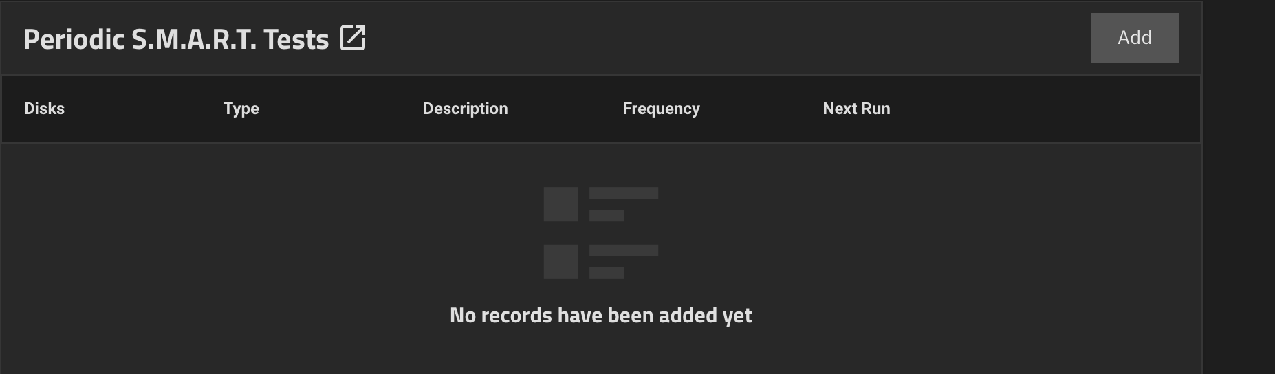

SMART is enabled by default on all my spinning disks, and I’ve successfully run manual tests on all of them, but …
By default there are no scheduled SMART tests.
I’d like to schedule some, and in my OP was trying to figure out if there were any TrueNAS-specific caveats to doing that.
I phrased it poorly. Sorry. :slight_smile:
