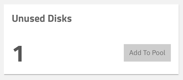

However, as it turns out, rebooting the server one more time and re-seating the drive, makes it available:
I will add it to the pool. Hopefully, that’s the last I had to deal with this issue!

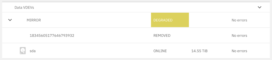

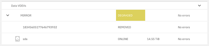

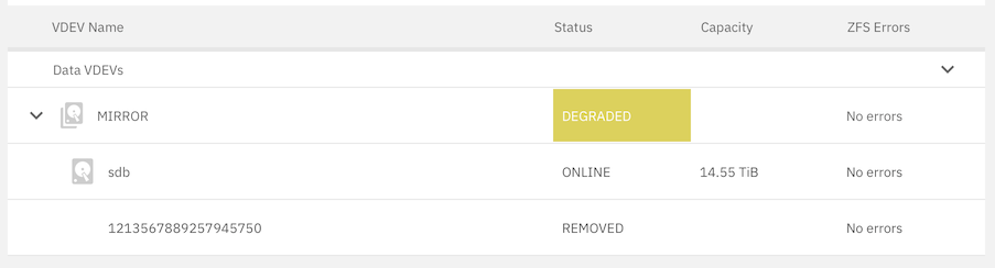

Back to Square 1:
REMOVED but “No errors.” What is going on?
If there are no errors, then I cannot get to the bottom of why it was removed. And, yet, there has to be something that triggered it.
