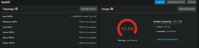

What’s the geometry of tank0?
If it is a mirror or a single drive (degenerate mirror of sorts), you can just evolve from your current setup to the new one. (Assuming that the new drives are at least as large as the old one(s) and you mean “mirror” by “RAID1”—vocabulary matters here.)

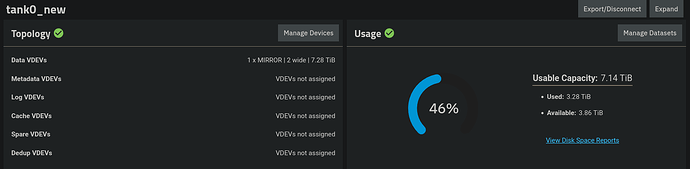

It’s a mirror with two 4TB WD Reds:
The new disks are two 8TB Seagate IronWolfs:
