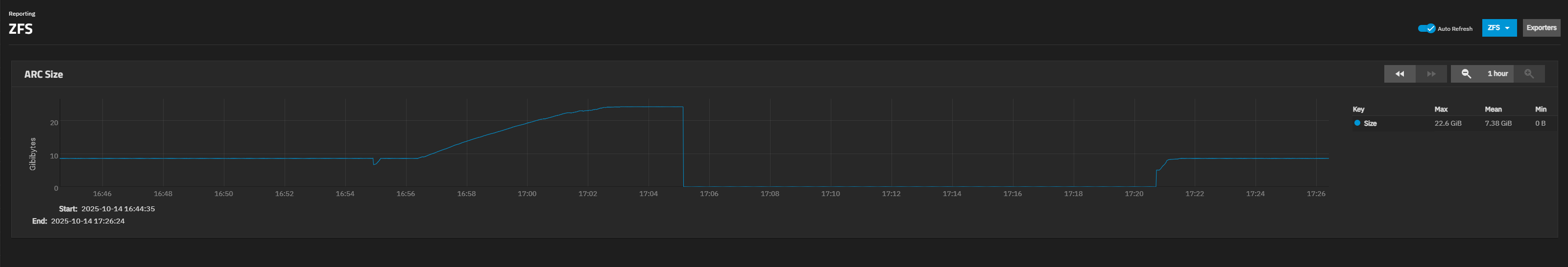

Here is a screenshot from the ZFS Arc size graph from when this occurred today. Each of the four instances that this has happened all follow a similar pattern.

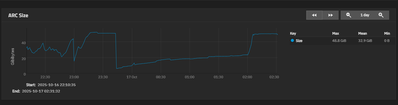

This is a screenshot of when it ocurred yesterday.
At the time that both of these spikes occurred, /var/log/syslog shows that the kernel started invoking oom-killer.
I will note that I tried adding a pre-init script under System > Advanced > Init/Shutdown Scripts that does the following: echo 8589934592 >> /sys/module/zfs/parameters/zfs_arc_max. This number is reflected in the screenshot of the first graph. However, this change does not seem to have had any effect (since the first 3 times this occurred was before I had this pre-init script in place).
Does anyone have any clues as to what is happening? Could the ZFS ARC size growth be a symptom of some other process hogging memory?

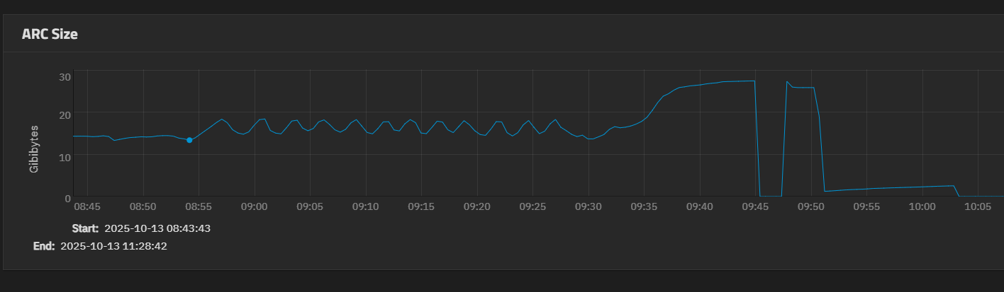

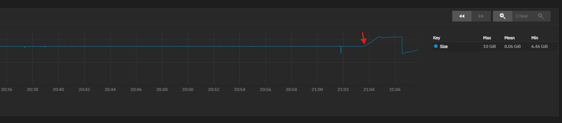

Hey guys, here is another side effect I have noticed.
Right when the ARC size starts to climb, I completely lose SMB and the networking speed of my qBittorrent VPN container drops to a crawl. The system is still usable and can still reach the internet, but both SMB and qBittorrent are mostly dead until the sharp drop off a few minutes later.
Does this tell anyone anything?
So in the past, we’ve seen at least 1 example where arc and an ipgu were fighting for memory. Arc on linux doesn’t clear as fast as it did on core.

So guys, even with 64 GB of RAM, the kernel still felt it necessary to invoke oom-killer. The screenshot shows the timeline from October 16th. /var/log/syslog shows that the kernel killed qBittorrent right at 11:15. The timing with oom-killer and the sharp dropoff in the ARC size seem too close for it to be coincidental. I will note that I did update the qBittorrent container to allow it 8 GB of RAM a bit after I had installed the 64 GB of RAM. Perhaps that was a mistake?
