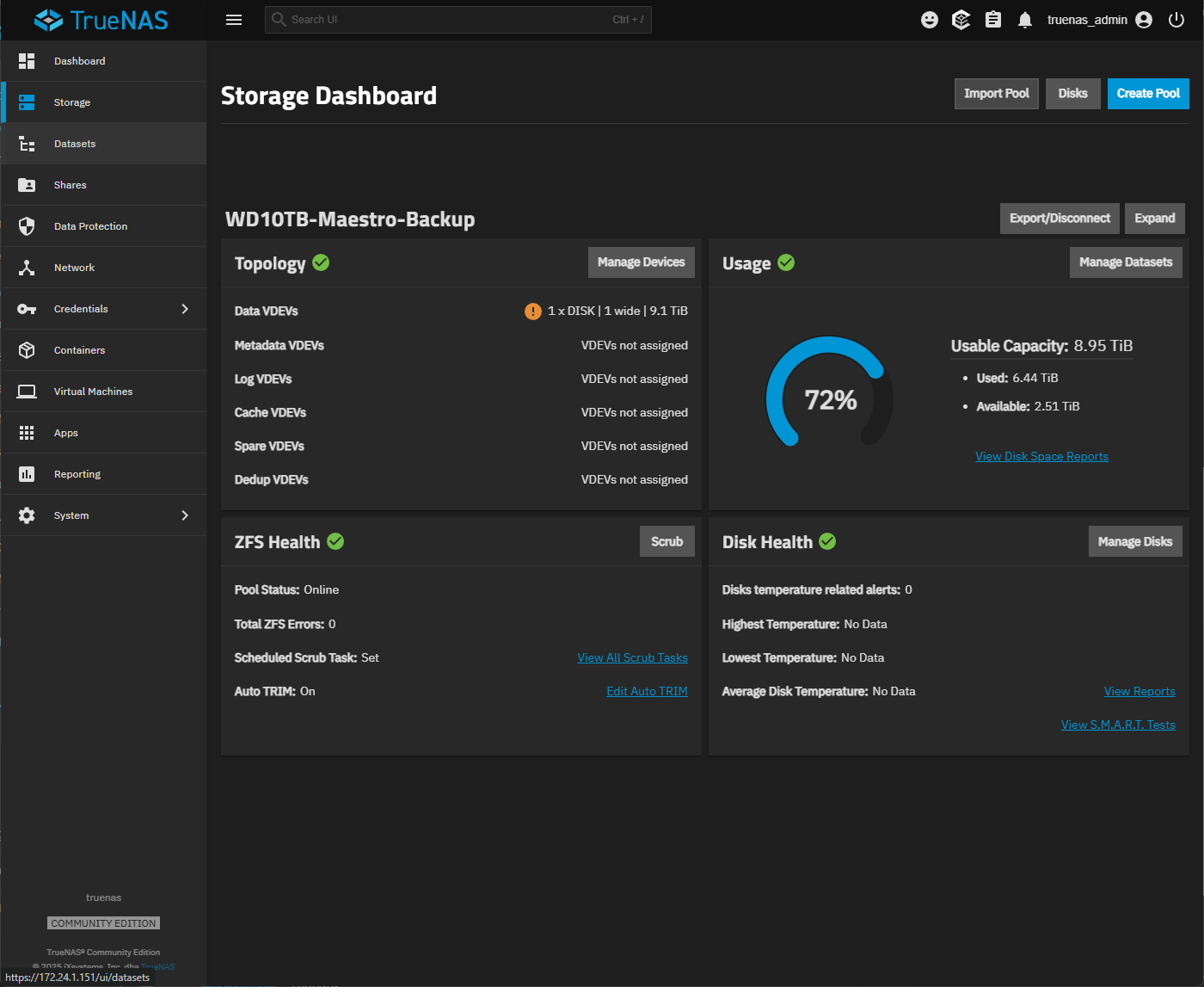

I had a new 10TB WesternDigital 3.5" Red Plus HDD. I attached it to a MiniPC running TrueNAS 25.04.2.6 (with limited SATA ports) via USB using an external adapter. I created a Pool, together with 2 Datasets – unencrypted. Then created SMB shares for the Datasets, and used both ‘rsync’ from another older stable TrueNAS-13.0-U5.3, and also manually copied – via Windows 11 File Explorer – a bunch of files and folders to the disk.
But when I connect this disk on a different TrueNAS server (also running 25.04.2.6) using SATA ===> *** PROBLEM ***
Using SATA the TN server does not see the ZFS Pool, so I can not import it. The command ‘sudo lsblk’ shows only the basic device (“/dev/sda”) without the primary partition (“/dev/sda1”). The most interesting output is from ‘sudo fdisk -l /dev/sda’. I have attached the PNG screenshot of the output. Doing all three of these things (“Import Pool”, “lsblk” and “fdisk -l”) on either of the two TN25.04.2.6 servers using USB results in no issues.

So … I guess it’s an old Seagate product. Has worked well for me on many different drives, including the 10TB WD Red Plus. It shows as 9.1TB using ‘lsblk’. In TrueNAS – when attached with USB – it shows a 8.95TiB “Usable Capacity”.
Below: the ‘du’ takes several minutes to run since USB (even 3.0) is slow.
Anything else you’d like to see ?
