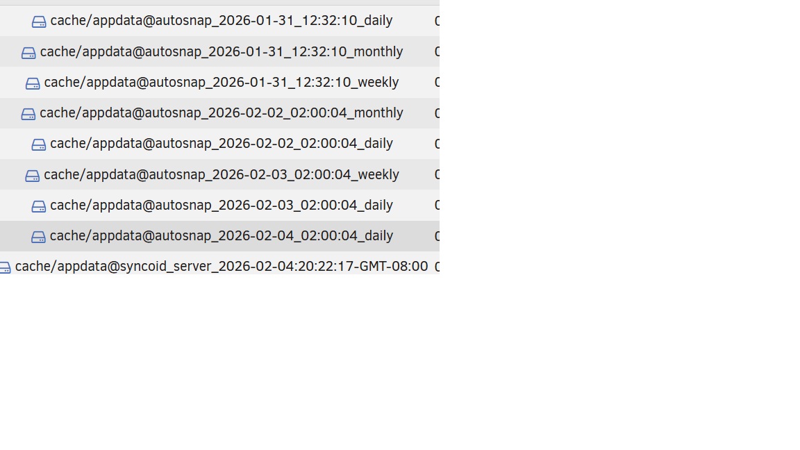

can’t get Truenas to see my snapshots, not sure how to set the expression. my files look like this:
If its not a permissions thing, where TrueNAS simply can’t read the source snapshots, then it most likely be your matching naming schema in the TrueNAS replication task is incorrect.
Based on your screenshot and snapshot naming convention, try these strings:
autosnap_%Y-%m-%d_%H:%M:%S_daily
autosnap_%Y-%m-%d_%H:%M:%S_weekly
autosnap_%Y-%m-%d_%H:%M:%S_monthly
or if you wanted to match on all three variants with one schema:
autosnap_%Y-%m-%d_%H:%M:%S_(daily|weekly|monthly)
or you can just put all three strings into the naming schema field, it supports multiple strings.
