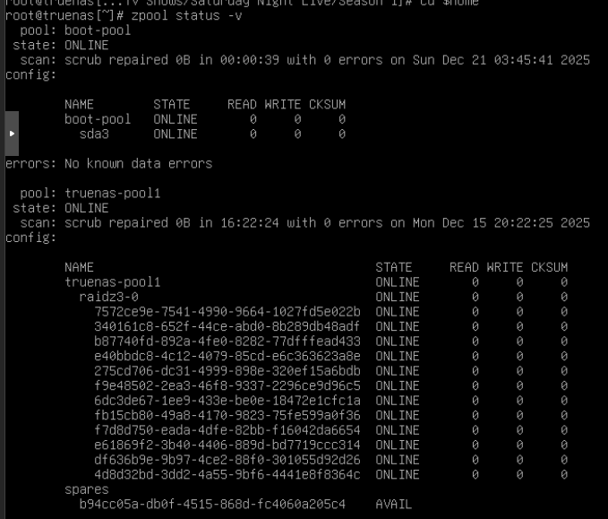

With this I can see the data in the mount and I am able to run zpool status:
From here is where my issue diverges from the original thread. As far as I can tell in my limited knowledge, the pool is fine. Unlike the OP from that thread I am using ECC RAM and see no reports of metadata corruption. However, I figure it is now best to ask for advice on what to do next. Do I scrub the pool and re-enable ix-zfs.service and see if TrueNAS will mount as expected? Should I perhaps try to mount manually after a scrub? Do I immediately migrate all the data and rebuild? I don’t want to make any further changes in recovery mode without some expert advice. If there is any missing information needed I am happy to provide it. Thanks in advance!
