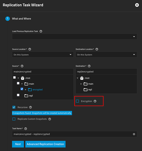

Hello, I am currently trying to configure a new replication task as follows:
What confuses me, is the blue hint/warning in low middle:
0 snapshots found. Snapshots will be created automatically.
In my view, I’ve done everything to allow for proper replication:
  • main/encrypted is the parent of a couple child datasets.
  • Multiple snapshots already exist for each child dataset.
  • All of these snapshots have been created by automated snapshot tasks.
  • Retention policy "Will be automatically destroyed at … " is shown for all of these snapshots.
Periodic job example (dataset and naming schema):
main/encrypted/media → auto-media-weekly-%Y-%m-%d_%H-%M
I also tried to directly select a single child dataset like main/encrypted/media, but the same warning is shown.
Why doesn’t TrueNAS recognize any snapshots here, and sees need to create ones? TIA

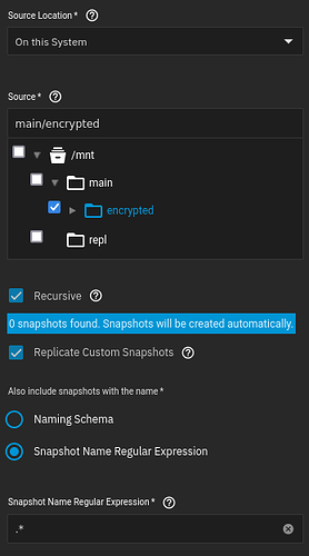

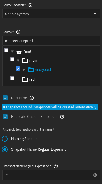

What still does not work: Selecting a parent dataset source with “Recursive” option and using any naming schema for snapshots of contained child datasets, or even wilcard .* - none of the snapshots are found here.
To illustrate
with a screenshot: Shouldn’t this configuration find all snapshots from child datasets under main/encrypted?
Or should I rather create own replication jobs for each child dataset (which is more work to do)?
Am I understanding this correctly? You created Periodic Snapshot Tasks for each child dataset, but not as atomic recursive snapshots on the parent itself?
When you select the parent as the “source”, the replication (zfs send) is contingent on the parent itself to have the relevant snapshots. Only if the child datasets have the same atomic/recursive snapshots will they also be replicated in tandem.
Look at it this way: Where the replication “begins” from a top-down hierarchy, is where the snapshots must be found from a top-down hierarchy.
