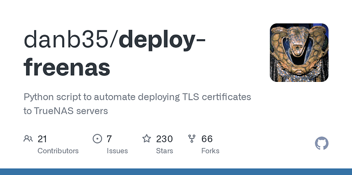

Short answer: check the acme.sh docs. But it’d be something like acme.sh --install-cert -d '*.lang-w.de' --deploy-hook truenas_ws.
Or you can use my script:
Or tnascert-deploy:
Peter, See my sample-scripts directory at tnascert-deploy It may be helpful to you in using either tool, @dan deploy-freenas or tnascert-deploy

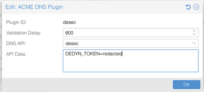

I don’t really understand why the TrueNAS ACME implementation is so needlessly complicated? Maybe they just assume that everyone uses cloudflare?

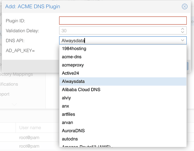

As a comparison, here is how it is implemented in Proxmox.
That is it. So simple.
Proxmox also offers way more providers, from 1984hosting to zonomi. My guess is just every provider implemented into ACME.
I really don’t understand why TrueNAS implementation is so complicated and at the same time so limited :face_with_diagonal_mouth:

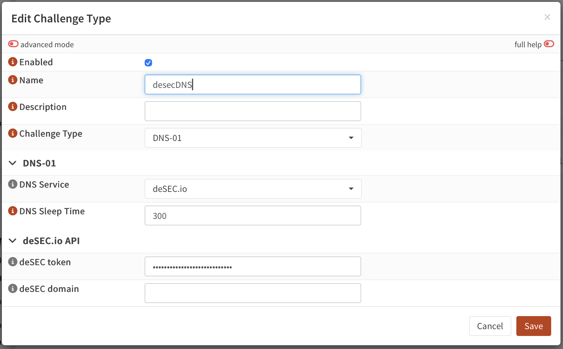

I agree, OPNsense is doing it even simpler than Proxmox:
The current TrueNAS implementation feels insane compared to that.

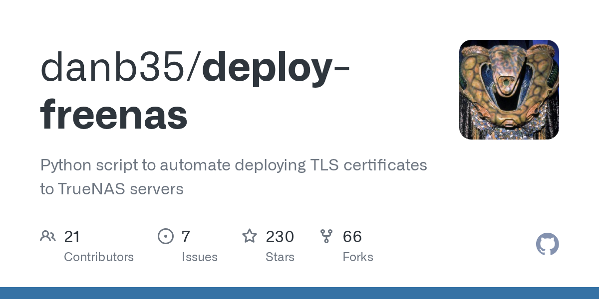

This is pretty much why I run my ACME client on my FreeBSD web server VM. I then deploy my wildcard cert from there to various other web apps that I use including TrueNAS with the deployment hook.
