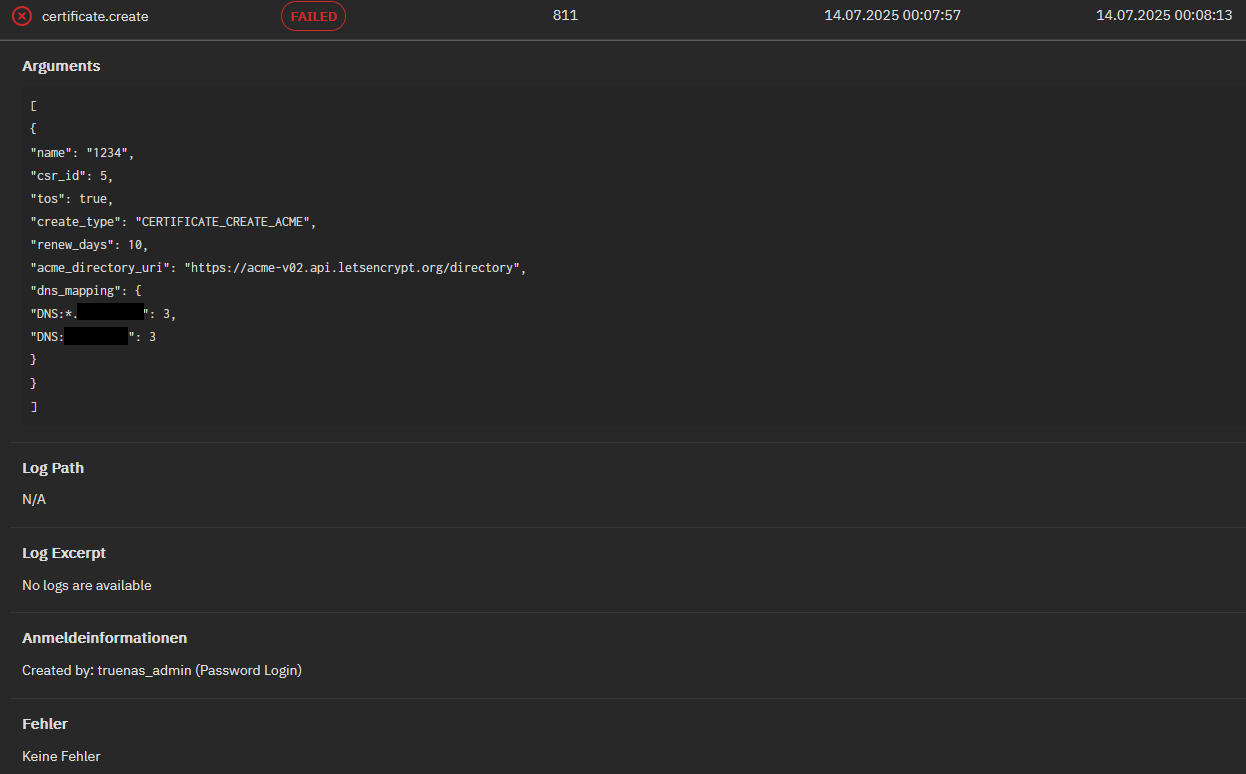

Hey there,
I’m currently trying to get that shell-script implementation for acme.sh working.
I’m using this tutorial as guide:

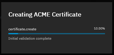

Now my issue is, that GUI process window will vanish after “Initial validation complete”;
Leaving the job as failed - with no logs and “no errors”.
I am able to manually request certificates via acme.sh - that thing seems to be working. Might be something with GUI or this acmeShellAuth.sh script from the guide. Maybe something very basic might fail. Like permissions etc… - but for testing / debugging I’ve set everything involved to 777 which lets permissions not look like the culprit this time…
Can you give me a hint where to start searching for whats failing? Why does that progress notification gets closed without any error message?!

Known bug, supposedly will be fixed in 25.04.2. As an alternative, see:

Thanks for your replies, so GUI is indeed bugged currently, not my fault?
